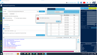

I'm using STM32F423ZHT6 Board. I want to upload the image file (.bin) to my MCU board via STM32CubeIDE.
Please any one help me to complete my task.

I want load a image into external flash memory [QSPI]. Is there any easy way to do it?
@Pavel A. How to do it in CubeProgrammer. I tried but I can't flash the .BIN into my external flash memory. Can you please help me to solve the task?

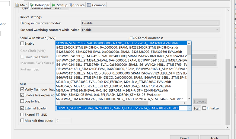

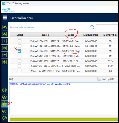

In IDE choice one external loader right for you in running config
simmilar in PRG. But for custom boards and flash you must write own stldr based on docu...

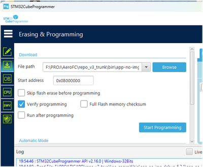

Sure! No video needed, it is super simple. Just open the Programmer, connect to the board.
Then select Erasing and programming. Browse for the .bin file and enter the start address. and other options as needed.
Good luck.

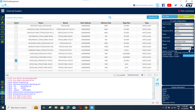

you little skip word EXTERNAL
Specify the external loader(s) for the external, and the address in its range. And there you go.
Hi @Pavel A.

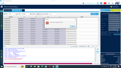

This is my external flash loader. Then I try to download the .bin file it shown error.
I tried this method also, this time also I got same error. How to fix it @MM..1
Is there any other way to flash memory? Please help me
