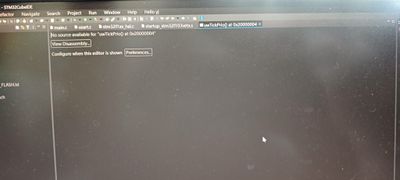

When compiling and debugging with STM32CubeIDE, it shows: uwTickprio0 at 0x200000004 has no available source and the burner is using stlink v2. What is the cause of this problem?

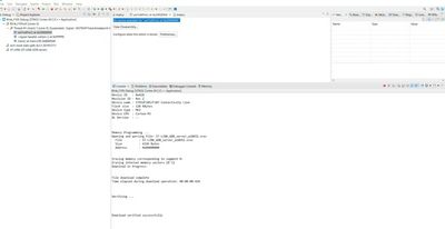

What I want to ask is, why is this problem: No Source Available for "uwTickprio0 at 0x20000004, how to solve it? The compiler is STM32CubeIDE 1.12.1, and the programming device is ST-LINK.

Pavel A.
Likely the program jumped to data (corrupted stack?)
Probably because you've placed a break-point or watch-point over the variable.
It's not something that's "code" and it can't disassemble or associated it with any of the debug information or source/line details.
Is it possible to clear all watch/break-points prior to debug.
Or catch the HardFault or whatever call-tree it's trying to unpack/unwind here?
Perhaps show what exactly you're doing in main(),  or within the main.c file at line 95 ?
The address 20000004 is on call stack. Does not look like data breakpoint.
