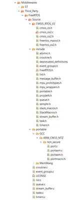

I'm stuck in the following issue. In my STM32 project I'm using FreeRTOS which I have enabled using CubeMX. In my project tree I have the following files:
At the same time I have included the following paths:
When I check the file with the error and try to find the referenece the header file is found and opened normally. All the .c files are in place as you can see.
Do you know what could be the issue?

The file cmsis_os2.c includes the definition of all the functions that seem to be undefined. It's in Middlewares/Third_Party/FreeRTOS/Source/CMSIS_RTOS_V2.

You screenshot is a bit low-res to see clearly, but it looks like that file has errors:
So maybe it wasn't (successfully) built ?
Lyap94
You are right. There are two files that have errors:
- cmsis_os2.c --> SemaphoreHandle_t and QueueHandle_t could not be resolved
- semphr.h --> Where typedef QueueHandle_t SemaphoreHandle_t; is defined
The problem starts there I think because the QueueHandle_t cannot be resolved. It is defined in queue.h which is also included...
