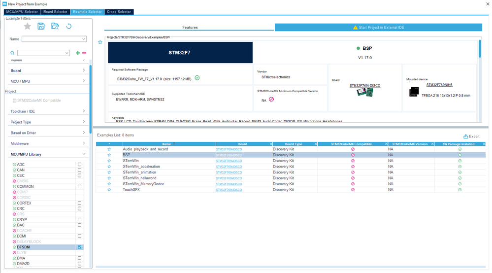

Hello @IWhit.2​
I was not able to reproduce the misbehavior you mentioned in your post. Perhaps we are not using the same environment.
I have conduced the test on the "BSP" example for "DFSDM" Library with CubeMx 6.6.1 and CubeIDE 1.10.1.
To be able to push the analysis further, I will need a link for the project you used and the complete compilation log.
Kind regards,
Semer.
