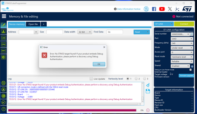

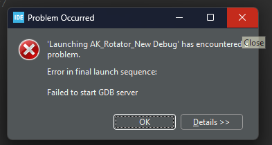

Unable to upload my code using Serial Wire Debug
vbk22398
  I am trying to upload my code using ST Link(SWD)into a custom board with an STM32 Core. I am using serial wire debug for programming. So I am getting the above shown error messages. If anyone have come across this issue, please help me resolve it.
 I tried uploading the code using STM Cube Programmer also. I am getting the above error.!

 I also tried shorting the Boot0 and power cycling it but still the same issue persists.
https://stackoverflow.com/questions/61106861/how-can-i-start-the-gdb-server-in-stm32cubeide
Start with multimeter and check 5V 3V3 Vcap pin voltage usw. Plus remove chaos R2 R24 ...
> sir what should i do?
Remove R2, verify voltage across VCAP is 1.2V, try to program it.
BOOT0 can stop you code from running if it interferes with operation. The BOOT0 HIGH / POWER CYCLE is more of an H7 recovery method.
Bond the VSSA / VSS more directly, ie with wire
STM32L496ZG ? So you're using the NUCLEO-L496ZG's ST-LINK for this?
Make sure the on-board L496 target is disconnected via it's jumpers.
I don't recall the STM32F423RH having P or Q variants with different pin-outs, but that would be a concern for L4+ parts.

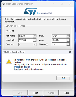

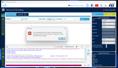

With respect to the above link I am getting the following issues across various applications.
I am still unable to program my custom board using the i.ST-LINK, ii.USB to UART(TTL), iii.another Evaluation board debugger IC. I don't know what the issue is. I have tried connecting the BOOT0 Pin to logic high and logic low, both. Kindly help me with the same.
