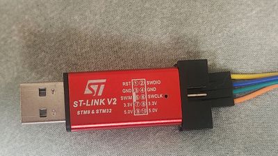

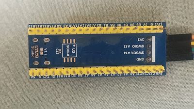

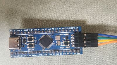

HWrst mode won't work unless you're connecting NRST. Assuming you just do 3V3,GND,SWDIO,SWCLK
I might check an old version of ST-LINK Utilities, it might be less fussy about counterfeit Chip ID's
A picture of the chip/setup might be instructive.
 here are the pics of the setup ... the st-link looks authentic, but now, I'm so sure about the chip itself.  Although I've been led to believe that the WeAct Studio product is good.

I didn't know about the St-Link Utility ... found it and used it in conjunction with you instructions.
I was still unable to detect the STM32F103 but I was able to detect and read the STM32F411 Black Pill board that I bought at the same time.
I suspect you may well be right about the F103 board ... it may be damaged or broken.
