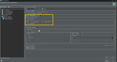

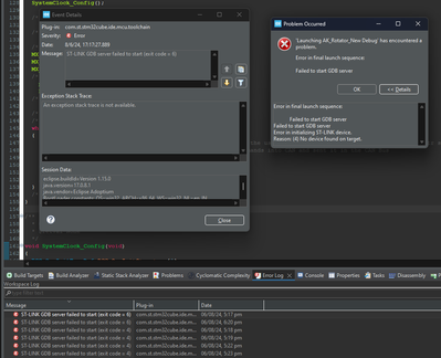

I am trying to upload my code using ST Link(SWD)into a custom board with an STM32 Core. I am using serial wire debug for programming. So I am getting the above shown error messages. If anyone have come across this issue, please help me resolve it.
I tried uploading the code using STM Cube Programmer also. I am getting the above error.!

    I tried programming the custom designed board using
    i.) an external ST-LINK and also
    ii.) using the debugger IC in the evaluation board(STM32L496ZGT6).
    Both gave the same error as i mentioned in the previous posts.
    NOTE:
    I am able to program an Evaluation board without using the On-chip debugger IC by using an external ST-LINK. But not able to do the same with the custom designed board. Not able to find the underlying cause.!
    In the debugger configuration I am able to detect the IC of the custom board. I am using Evaluation version debugger IC of STM32L496ZG to program a STM32F423RH. I am able to detect this IC when I change the setting to Segger J Link. I dont know why this happens.

    With respect to the above link I am getting the following issues across various applications.
    I am still unable to program my custom board using the i.ST-LINK, ii.USB to UART(TTL), iii.another Evaluation board debugger IC. I don't know what the issue is. I have tried connecting the BOOT0 Pin to logic high and logic low, both. Kindly help me with the same.

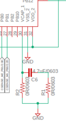

    @Tesla DeLorean  I checked with the ST-LINK, it is properly programming the Evaluation board. I don't know much about schematics and not able to find the issue in hardware side. The supply voltages I have checked with multimeter across Vcap and Vss is shorted correctly. I am struck here and not able to move further sir.!
    LCE
    Principal II
    August 8, 2024
    @vbk22398 See TDK's post above: REMOVE R2 !
    You're shorting VCAP to GND, which makes no sense at all, and might have killed the MCU.
