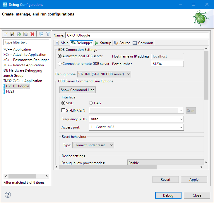

‎2023-12-11 7:08 AM
Hello Nikita,
I'm not sure this is your problem, but the STM32H5 needs to communicate via Access Port 1, make sure this is correct in the Run/Debug settings.
It is a common misconfiguration when using H5.
The STM32CubeProgrammer switches automatically to Access Port 1, but I'm not sure for STM32CubeIDE.
For the H723 board, I have no clue.
‎2023-12-11 7:51 AM
Yes the IDE selected the access port 1:
It's the only choice.

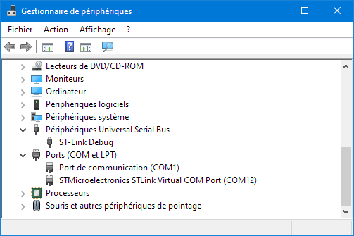

‎2023-12-13 3:26 AM
Thank you.
How I check if STLinkServer and STLink usb drivers are installed?
Il did the standard CubeIDE install.
The device manager shows:
The CubeIDE V1.14.0 required the STLINK firmware upgrade to:
Version: V3J13M4
Build: Jun 16 2023 16:43:25
I think the USB cable is OK because I use it for a long time, and CubeProgrammer works flawlessly with it.
Do CubeIDE and CubeProgrammer use different drivers?
