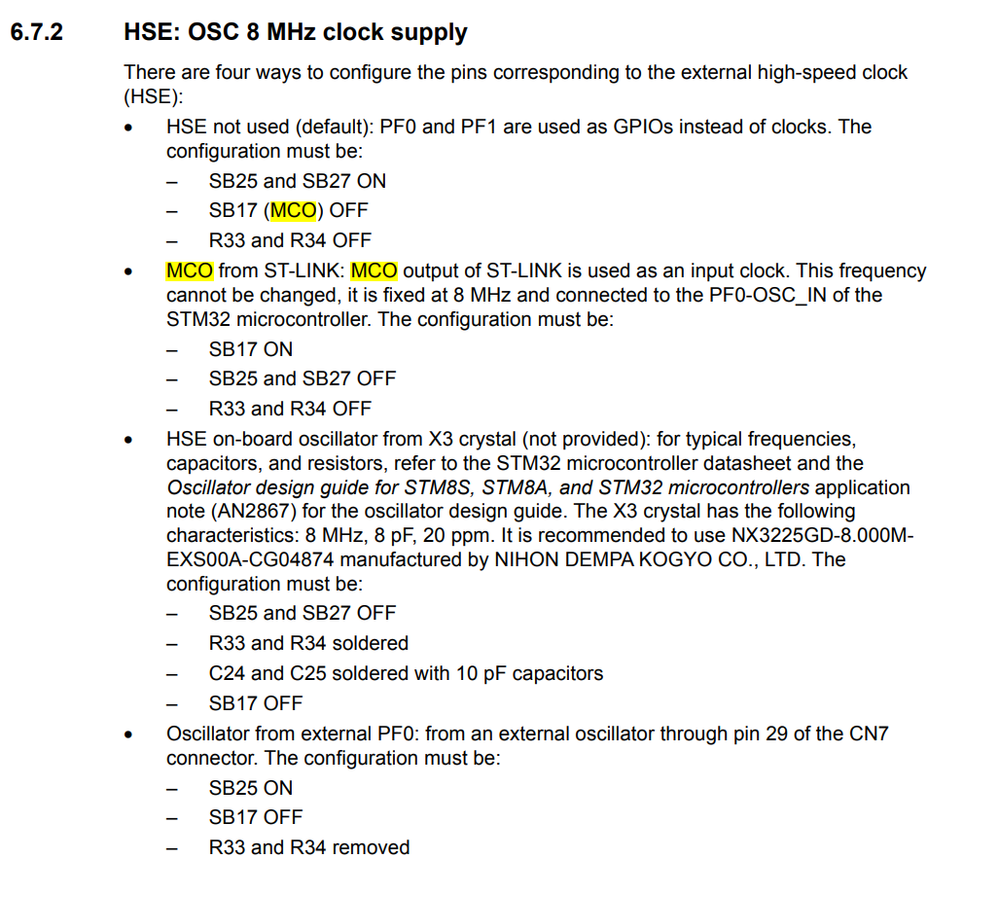

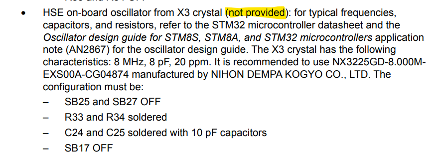

Per the User Manual for the Nucleo-G071RB
Further more you can configure the target to use MCO from STLink:
I modified your register level code to start up the HSI at 64MHz, this code woks and is tested, the rest of you code I did not implement:

when I tried to uncomment SystemClockConfig() and debug it, after stepping in line: RCC->CR |= RCC_CR_HSEON; it sets the HSEON bit in RCC_CR register to 1 but having the HSION and HSIRDY bit still 1 aswell
when i step into next instruction:while(!(RCC->CR & RCC_CR_HSERDY)); the code execution never leaves the loop and the debug is stuck in there as the RCC_CR_HSERDY bit does not set.....I believe this suggests that the clock is not switched to HSE
could advise on why this might be the issue?
my guess is that the clock frequency is not set accordingly and as I am unable to set it from Options for target - Target tab as Xtal frequency is greyed out as <undefined> I dont know how I can set the frequency to 64MHz before debug
any help would be appreciated
