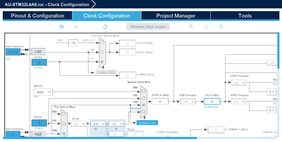

i setup the STM32L4A6RGTx ioc, and try to configure LSE, but can't becinfugred in Clock configuration page.
it was set to grey.
whether anybody knows the reason?
CUBEIDE 1.13.2
MX 6.9.2-RC4

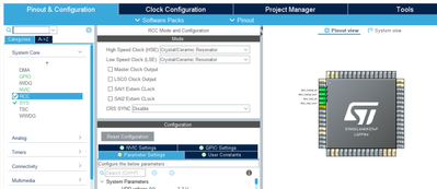

It works for me using latest release of CubeMx version 6.11.0. Please try with this version and keep me informed about your progress.
You must activate either RTC or LCD.

Hello @Owenlu ,
How have you configured the LSE clock source in the Pinout and configuration tab?
Please follow this FAQ with step-by-step to properly configure LSE:

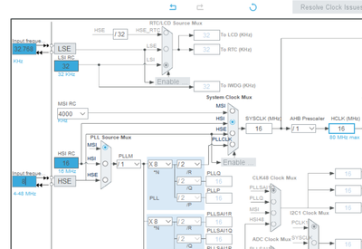

Owenlu
i did follow the guideline above. the problems not fixed
LSE still can't be configured and in grey color

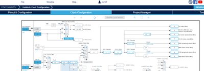

Imen.D
