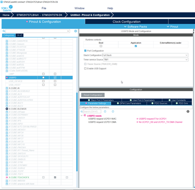

I am trying to create a project that uses both the Nucleo GFX01M2 and SNK1M1 with the G071RB dev board. I want to configure my setup as a USB sink device. However, in STM32CubeMX I can select either the sink USBPD application, or the Touchgfx graphics application, but not both. What would be the best way to develop an application that utilizes both USBPD and TouchGFX?

Hello @TS-LMG ,
I was able to enable both TouchGFX and USBPD for an STM32H7S7 board in STM32CubeMX:
(I first enabled TouchGFX, then CRC, then USBPD if that helps)
Note that it is pink because I did not configure everything correctly.
What versions are you using?
Can you share your project?
You could manually merge the files for the USBPD to a project with TouchGFX enabled by creating both project and then using a file/folder comparator to see what is missing but that would be quite some work.
