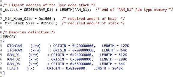

‎2022-06-01 5:19 PM
Successfully downloaded using STM32CubeIDE.
However, it appears to have been suspended because the program did not work (CAN, UART, LED control operations, etc.)
At this time, annotate a portion of the source code and make the program size 127 KB, which works normally.
My "FLASH.ld" file is as follows:
‎2022-06-01 5:50 PM
The base of the 2MB FLASH would be 0x08000000
The upper 1MB would start at 0x08100000
Not sure why it would limit to 127KB unless later in the script you direct content into the DTCMRAM
