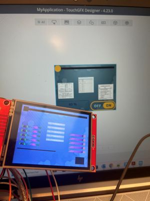

The load and read work if i use stm32programmer (i create and bin file, load it and read the right data) but if i use stm32cubeIde and touchgfx i have problem with the displaying.

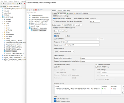

I add the stdlr file in my project and setting the run configurations like :

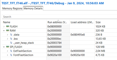

The datas are in the flash memory :

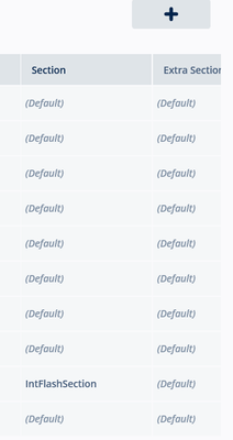

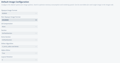

The configuration of my touchgfx is
The Background image is not in the flash it works but the others in flash doesn't.
this what i have
Do you have any idea why my image in flash is wrong.
