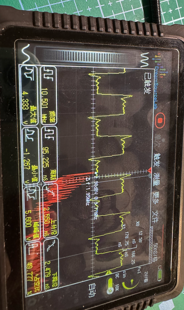

Hello, when I was using the SDIO of F407, I encountered a problem where the SD card could only read but not write. When I enabled "HardwareFlowControl" and set "ClockDiv" to 2, the function was normal. Why is that? When I operate the SDMMC of the H750, it's the same. It must be set to the above Settings.I checked the waveform of the SD card. In terms of waveform quality, it's okay.The waveform of the clock is shown in the following figureiShot_2026-05-19_04.02.36.png

Hello, you're quite right! You mean to ask me to pay attention to the frequency limit of the SD card itself. I checked my card, which belongs to class10 and has High Speed and Default Speed. Theoretically speaking, their clock buses can reach 50MHz and 25MHz. However, after my measurement, I found that after the STM32F407 was divided into two frequencies, the clock line speed of the SD card could reach 12MHz, and after the STM32H750 was divided into two frequencies, the clock line speed of the SD card could reach 50MHz. It is obvious that the STMF407 has not reached the upper limit of the SD card, so I am very puzzled about where the problem lies.
