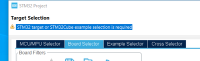

This is at the top of the screen

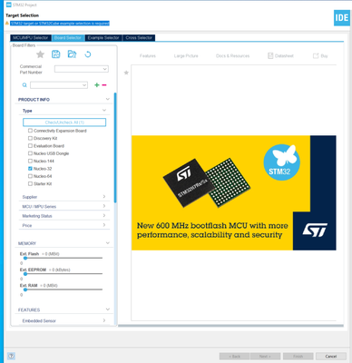

And as you can see below, there are no boards to be selected from.
 If I go back to the select by MCU/MPU instead of by board and already know what specific board I want, I can then click on the board as an option.
Also this only happens when I try to start a new project from inside STM32CubeIDE.   When I open CubeMX directly, the board selection tool works properly.
