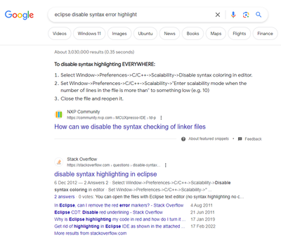

Could be a general Eclipse thing - not specific to the ST IDE - so try some general Eclipse searches?
eg,
https://www.eclipse.org/forums/index.php/t/75681/
Have you tried the preprocessor thing?
I spent hours trying to deactivate this error, including the google example, but I was unsuccessful.
