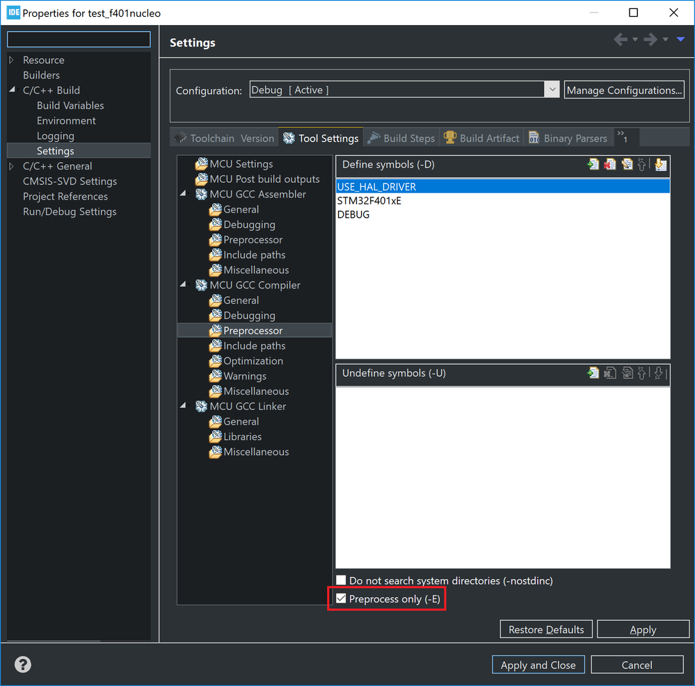

How do I see a C/C++ source file after preprocessing in STM32CubeIDE
I want to check if the preprocessing are correctly adding my function macros
TDKBest answer
July 29, 2020
Use the "Preprocess only" checkbox. After that, the converted files will be in the build directory with a "*.o" extension.

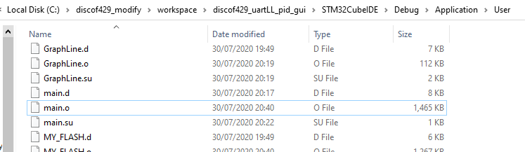

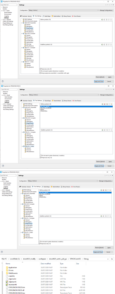

I checked the "Preprocess only" in all the places , and I open my Debug folder and sub directories ,I could not find the *.o extension. Am I doing it correctly?
EDIT: I found the main.o at last. It's in the sub directory users folder
