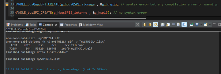

hello,
I have a syntax error on one line but no compilation error with stm32cubeide 1.14.1
HANDLE_busQuadSPI_CREATE(g_hbusQSPI_storage , &g_hqspi) ; //syntax error
HANDLE_busSPI_CREATE(g_hbusSPI3_interne , &g_hspi3); // no syntax error
with
#define HANDLE_busQuadSPI_CREATE(var, s) \
		busQuadSPI_handle_t var = { .quadSpiHal = s, .mutex = NULL , .state = QSPI_STATE_Ndef }
and
	#define HANDLE_busSPI_CREATE(var,s) \
			busSPI_handle_t var = { .spiHal = s, .mutex = NULL , .state = SPI_STATE_Ndef }
if I don't use macro : no syntax error
busQuadSPI_handle_t g_hbusQSPI_storage = {.quadSpiHal = &g_hqspi , .mutex = NULL , .state = QSPI_STATE_Ndef } ;
 what can happen?
Thanks in advance
I tried launching the preprocessor with this
https://community.st.com/t5/stm32cubeide-mcus/how-do-i-see-a-c-c-source-file-after-preprocessing-in/td-p/254677
I had a lot of not explicit errors (something not configured I would say) but... Eclipse asked me if I wanted to update the "indexes"
I said yes and I no longer have the syntax error :victory_hand:
I still have to understand what these indexes are...
Thank you all for your help

What exactly is the compiler error output and at what line/column in your code.
It could also help you to output the source code after preprocessing (-E option for gcc).
hth
KnarfB
The IDE syntax checking is limited. It does its best but isn't going to be 100% accurate. This style of initialization is relatively new and isn't always supported, especially on embedded hardware.

There is no compilation error, just a syntax error in the editor.
Macro HANDLE_busQuadSPI_CREATE and HANDLE_busSPI_CREATE are similar but only one syntax problem :thinking_face:, that's what I don't understand.
As the ide doesn't say what the problem is it's not very useful. Do you know if it is possible to deactivate these controls made by ide? What GCC say is probably quite sufficient, right?

If gcc compiles and links without errors (and ideally warnings), your code is okay. Sometimes the STM32CubeIDE shows issues in the Problems tab that I cannot understand either, so I safely ignore them (and switched to VS Code unless I need some advanced debugging features of the STM32CubeIDE).
The reason that you see only one syntax problem might simply be that the parser gives up after the first error detected because it couldn't recover from it.
As @KnarfB suggested, try running the source through the preprocessor, and then opening the pre-processed file in the IDE - that should help narrow-down where, exactly, the IDE is complaining.
+1.
I've also seen this in other IDEs: the in-editor syntax checking is not done by the compiler, so it can "disagree".
