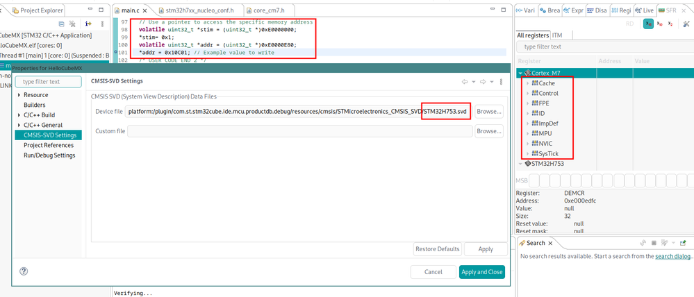

among probably many other registers, the ITM registers like TCR and Stimulus Port Registers described in the ITM programmers model in ARM Cortex-M7 Processor TRM are missing. Which means I either have to adapt the svd file or go to memory view and translate and modify the registers manually. Is this on purpose and or are there plans to fix this? If you have a repository somewhere I can maybe fix that on my own and start PR.
Ty in advance

Hello @ErdalHanedan
Your contribution is much appreciated.
Issue has been escalated to dev team under internal ticket ID 227361 for resolution
I will keep you posted with updates.
