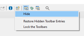

However, what I am asking is how to show the icons as they somehow are not in my toolbar.
How can I bring the perspective icons back ?

Yes, this helped. Thanks. But only sometimes. Othertimes, restarting the IDE helped to get icons back.
Interesting there is the option to "hide the perspective icons" when right click. There might be 'show' menu option somewhere.
