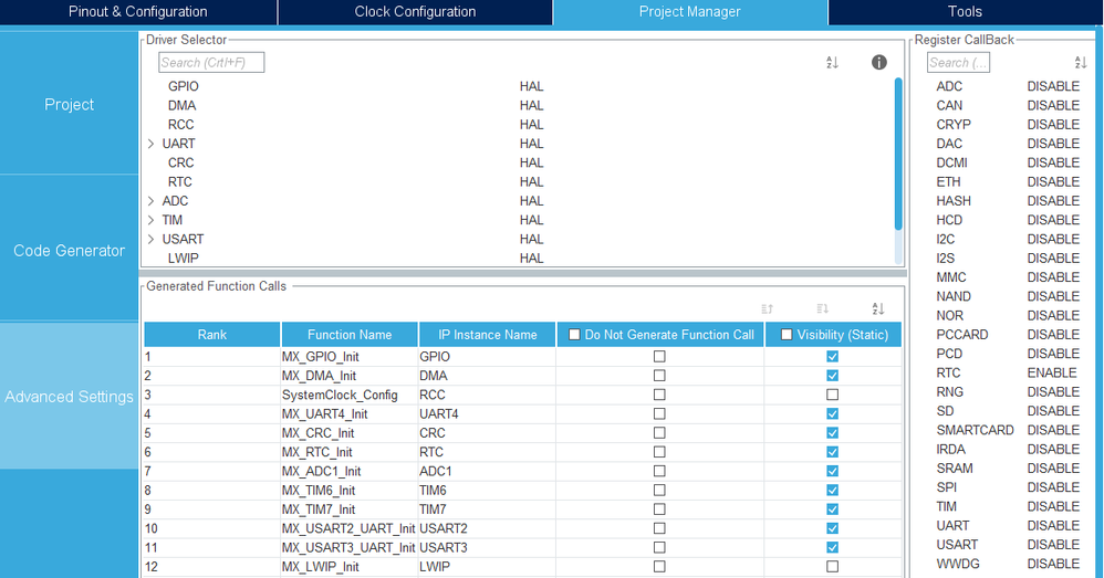

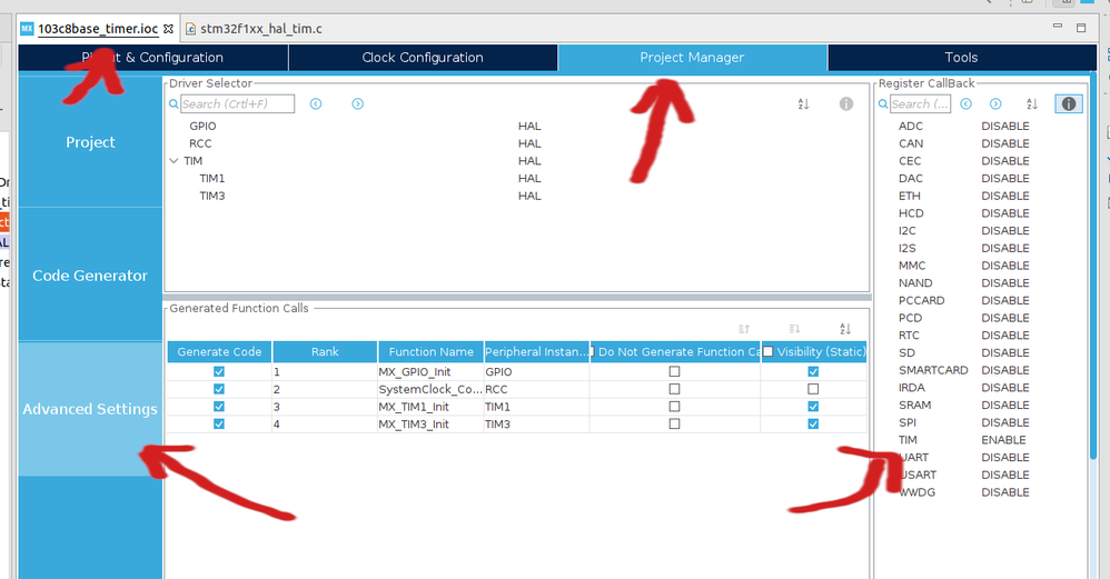

KnarfB
August 10, 2020
It's and old topic, but today i stumbled upon STM32CubeMX Project Manager > Advanced Settings > Register Callback where those settings can be configured.
TPeča.1
August 26, 2020
This feature has also been added to STM32CubeIDE 1.4.0 now.
Do note that the Register Callback pane might be obscured, you need to scroll right inside the device configuration window.
scottSD
Senior III
October 28, 2020
While this does actually work, it is annoying that the comment in the file still says "register callback disabled" even though it is enabled. For example:
#define USE_HAL_DCMI_REGISTER_CALLBACKS 1U /* DCMI register callback disabled */
This is not a functionality issue, but it would be nice if the comment reflected what the setting actually is.
