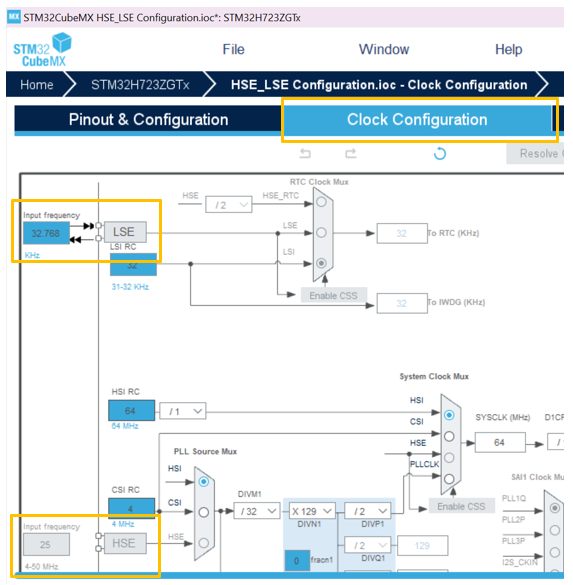

1. Checking your current HSE/LSE clock configuration in STM32CubeMX

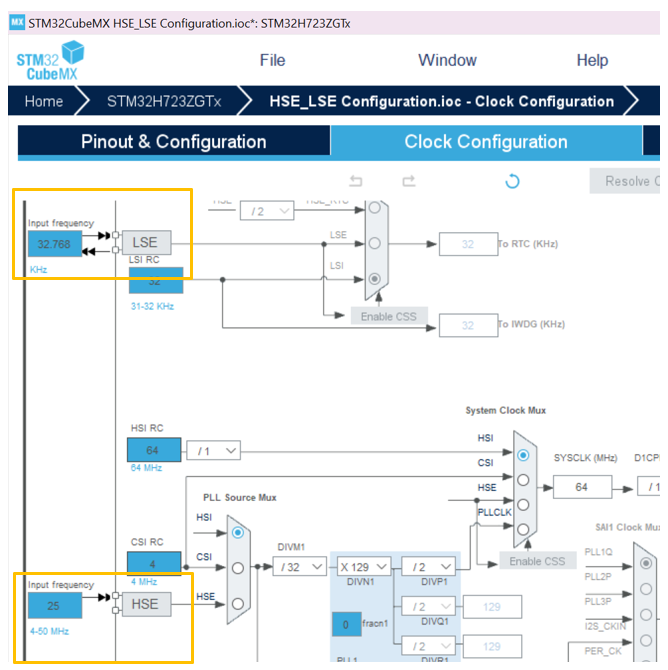

The quickest and easiest way to check if you have the HSE/LSE configured in your current project is by checking the clock configuration tab in your project’s .ioc file.
In the example HSE/LSE clock configuration below. We see that the input frequency to LSE is highlighted in blue while the input frequency to HSE is greyed out. Icons highlighted in blue are available and for the most part are modifiable while greyed out icons are unavailable and cannot be modified. Therefore, we can conclude that in this example case, the LSE is configured while the HSE is not.

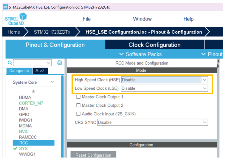

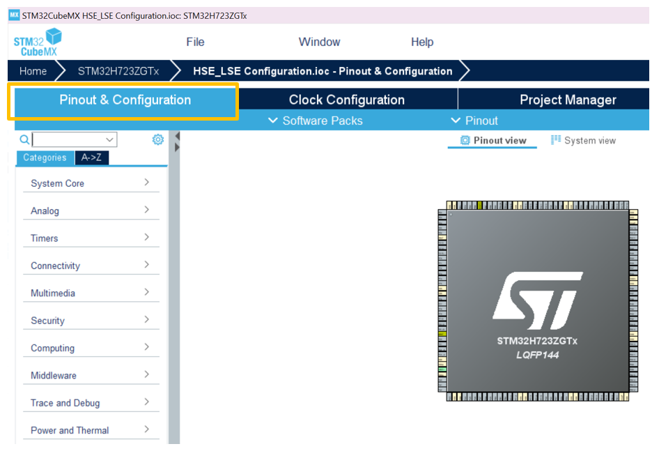

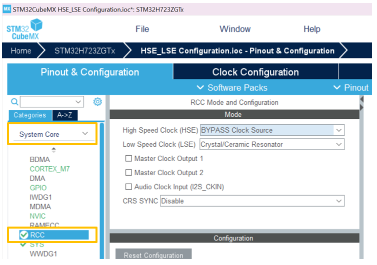

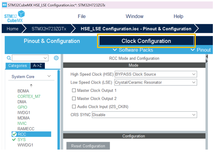

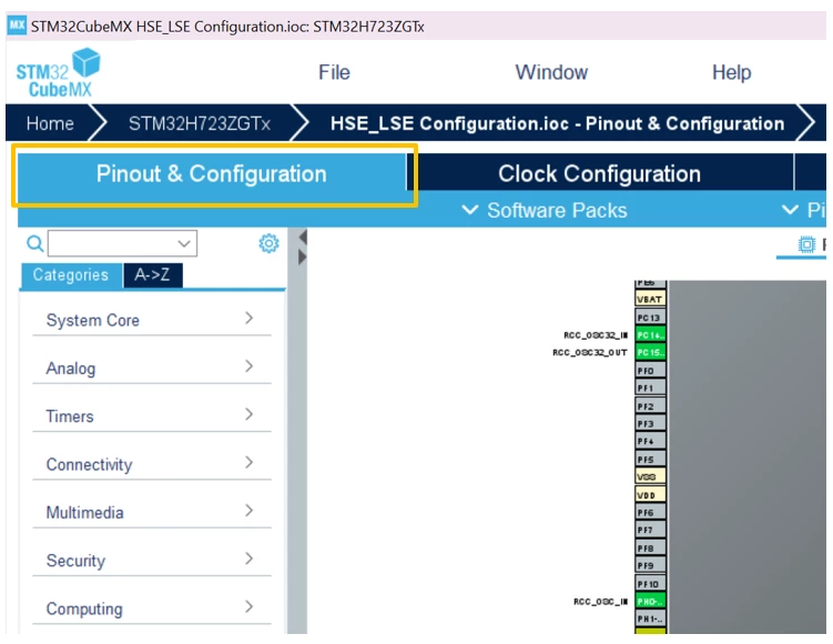

Step 1. Launch your project’s .ioc file, and start at the pinout and configuration tab.
Step 2. On the left-hand side navigation bar, expand the system Core tab and select RCC (Reset and Clock Controller). The RCC peripheral is used to control the internal peripherals including the reset signals and clock distribution. In the RCC category, you have the option to enable/disable the HSE, LSE, MCO (master clock output), Audio Clock Input (I2S_CKIN), and CRS Sync. In addition, configure parameters such as the MCU's power parameters, RCC parameters, the MCU's system parameters and PLL (phase-locked loop) range parameters.

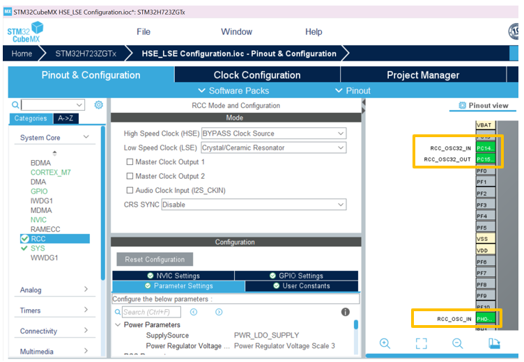

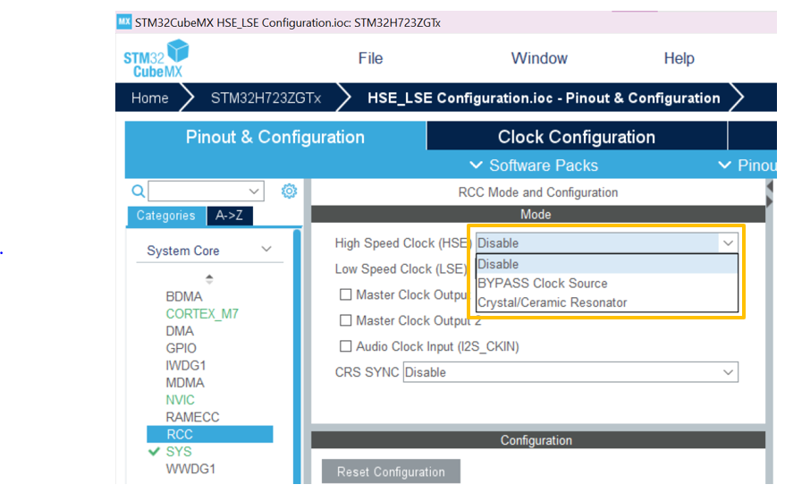

Step 3. In the middle panel (RCC mode and configuration), under mode next to High-Speed clock (HSE) and Low Speed Clock (LSE) you see an option for drop-down menus. By default, the HSE and the LSE are both disabled.

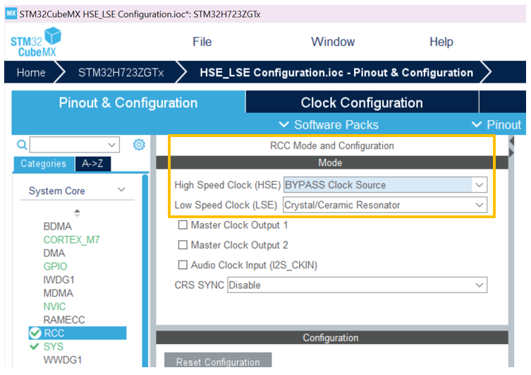

Step 4. There are 3 options that users can choose from to configure the HSE/LSE:
  • Disable – no HSE/LSE external clock source is selected
  • BYPASS clock source – the HSE/LSE clock can be provided from an external source using the OSC_IN and OSC32_IN pins. For more information on bypass requirements refer to your STM32’s reference manual namely, the HSE / LSE oscillator section.
  • Crystal/Ceramic resonator – the HSE/LSE clock can be provided from an external crystal/ceramic resonator

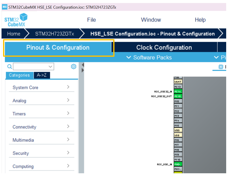

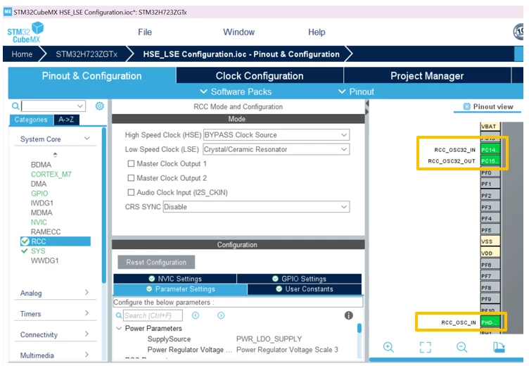

Once you have selected from the available HSE/LSE clock sources, you will also see the clock pins configured on the microcontroller’s pinout view, located on the right-hand panel of the STM32CubeMX GUI.

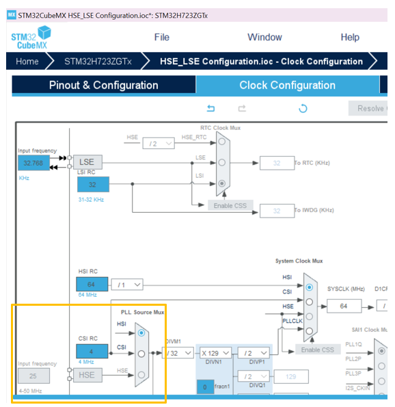

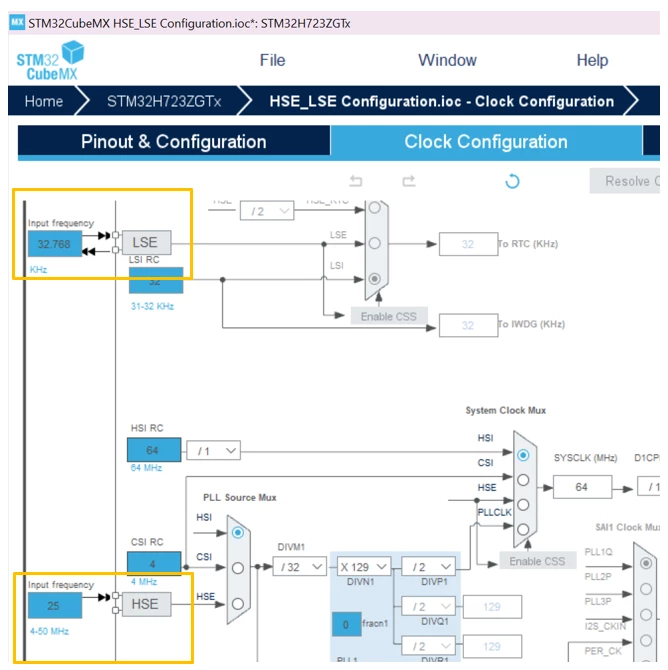

Step 5. To make additional modifications such as adjusting the HSE input frequency, select the clock configuration tab.
Step 6. On the left-hand side of the clock configuration view, you see the input frequency to HSE/LSE now highlighted in blue depending on your configuration for HSE/LSE in step 4. Boxes highlighted in blue are available and modifiable for the most part, while the greyed-out boxes are not available and cannot be modified by the user. In the example shown below, both the HSE and LSE are available.

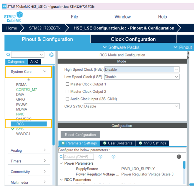

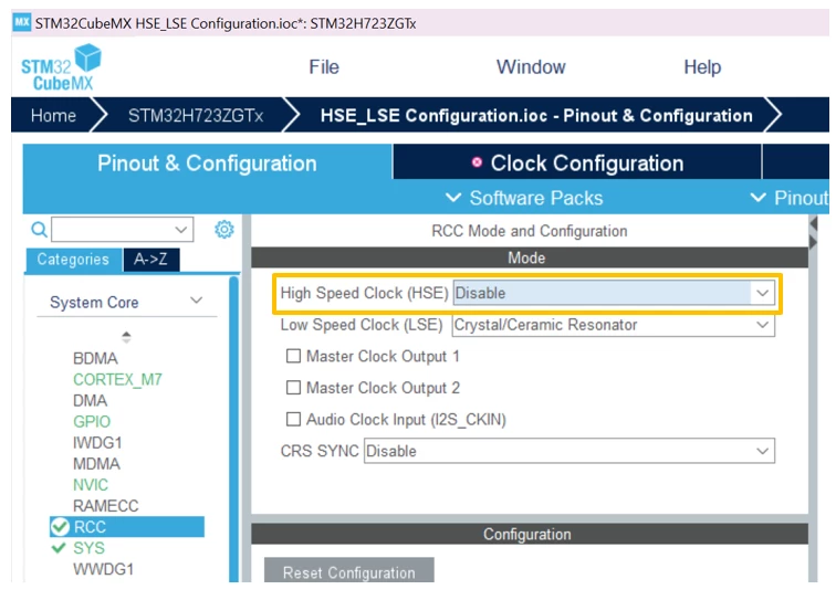

Step 2. On the left-hand side navigation bar, expand the system Core tab and select RCC.

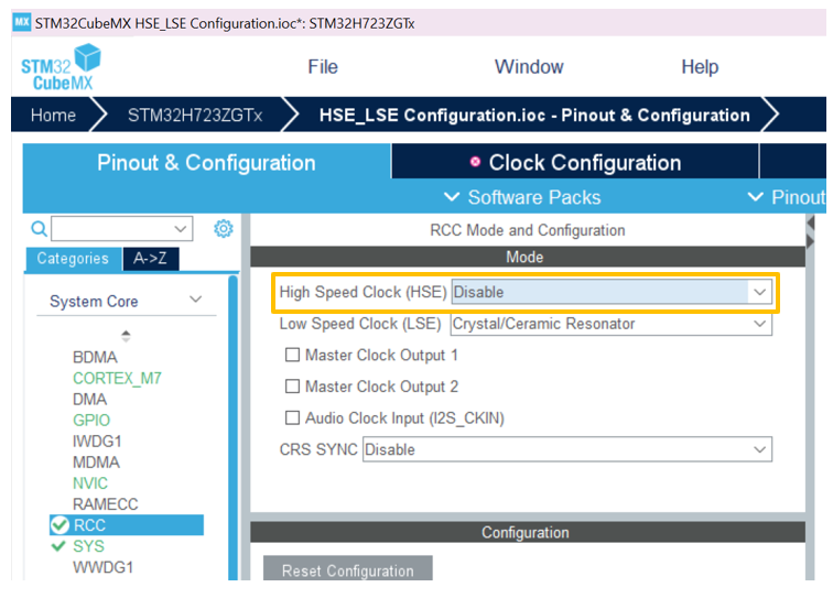

Step 3. In the middle panel (RCC mode and configuration), under Mode next to High Speed clock (HSE) and Low Speed clock (LSE) you see your current configuration(s) for HSE/LSE.
Step 4. To remove the HSE/LSE from your clock configuration, use the drop-down menu to change the HSE/LSE’s current clock option to disable.

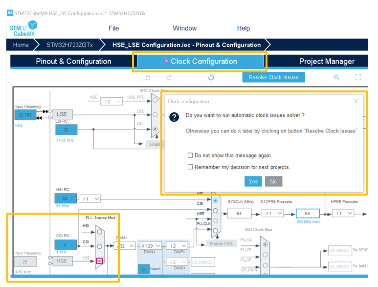

Step 5. To verify that the HSE/LSE clock configuration has indeed been removed, visit the clock Configuration tab. If you have previously modified the PLL source mux / RTC clock mux to be sourced by HSE or LSE respectively, then STM32CubeMX is smart enough to run its automatic clock resolver. This automatic clock resolver is a function that helps review and assists in resolving any glaring clock issues.
In this example case, we previously configured the HSE to feed into the PLL source mux therefore this clock configuration resolver pop-up appeared. We proceed forward by clicking yes and running the automatic clock issue solver.
After the automatic clock issue solver runs, we will then see that the HSE is no longer configured as the HSE and its input frequency block is greyed out and no longer a selectable option into the PLL source mux.
