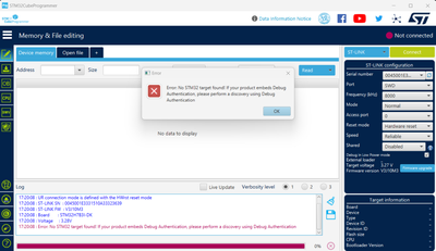

I am using 1.10.0 STM CUBE IDE. Everything was working fine until I unchecked the box to update STLINK firmware. Now it does not work. I later updated the firmware , but still not a thing changed. This is the message I get when I try to debug console:
Which box you did uncheck?
And if you try to connect with STM32CubeProgrammer? what happens?
I just unchecked the option to not show me again that window(window for firmware upgrade) , now tried with Programmer I also can't connect. It even can't "see" the board as accessible, even tho it is powered on an control LEDs are blinking.
What message is showing with CubeProgrammer?
Could you please share a screenshot of the error?
Are you sure you didn't modify any option byte?
Are you sure you didn't make any HW change to the board?
I found a solution , it was a little switch on the board which switches beetwen SYS_MEM and FLASH. All it needs to be done is noted on here: https://community.st.com/t5/stm32cubeprogrammer-mcus/stm32h7b3i-dk-error-no-stm32-target-found/td-p/303802.
