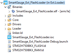

We have recently received source code from the company that was developing for us. This is our first time using a STM product, so we have some learning to do. We had them build a custom external loader and bootloader in addition to the main application. I have attached an image of the three projects. What is the correct way to build and deploy each project onto a clean board with no code on it?

As for using STMCubeIDE. If I want to edit the external loader (.stldr file), would I build the external loader project (which outputs a file named SmartGauge_Ext_FlashLoader.hex) and edit the .hex file extension into a .stldr extension? I then add the external loader into the Debug Configurations for both the bootloader and main application.
The .HEX for the STM32 Cube Programmer External Loader is of not help. The .STLDR is an ELF Object File, and is generated by the Linker. You'd only need to rebuild this if you changed your board, and the pins or part used for the external memory. Say you went for a different size, or brand. ie Micron MT25L128 vs Winbond W25Q256

So this output means nothing? I know we definitely do not plan on changing the External Memory anytime soon but would like some background knowledge on it. Thanks. SmartGauge is the name of the product.
The .ELF gets renamed to a .STLDR and copied into the \bin\ExternalLoader subdirectory of the STM32 Cube Programmer tool
