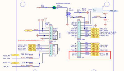

First of all I am kinda new in ARM (I never use), I am working on the STM32H745I-DISCO board (using the CM7 core) and I am facing a persistent issue with UART . No matter what I try, the RX Interrupt never triggers, and the code never enters the HAL_UART_RxCpltCallback.
My Setup: Board: STM32H745I-DISCO
IDE: STM32CubeIDE (Latest Version)
Scenario: UART Loopback Test (Connecting TX to RX physically).
Peripheral: USART6 (TX: PC6 / RX: PC7) on the Arduino Headers (D1/D0).
Settings: 115200 baud, 8N1, Asynchronous.
The Problem:
-HAL_UART_Transmit works fine (signals observed). HAL_UART_Receive_IT returns HAL_OK. However, the HAL_UART_RxCpltCallback is never executed. When checking SFRs in Debug mode: RXNE flag stays at 0.

Hello @EnesUNLU and welcome to the ST community,
As you can see from the board schematic, PC6 and PC7 are not exported on the Arduino header. Tx and Rx are exported on D0/D1 (PB10/PB11) on CN6 connector:
So for now use USART3 and connect PB10/PB11 together.

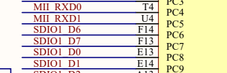

PC6 and PC7 are already used by the eMMC memory:
