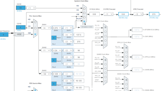

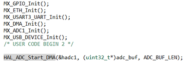

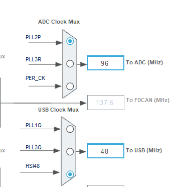

I am using STM32H723ZG nucleo board. When I enable HAL_ADC_Start_DMA(&hadc1, (uint32_t*)adc_buf, ADC_BUF_LEN); USB Virtual port doesn't show up and when I disable it, it shows up. Can anyone explain what could be the issue?
I was able to print "Hello" character using CDC_Transmit_HS function when DMA(in circular mode) wasn't enabled. When I enabled it, Virtual port doesn't show up. Please help me with this.
Above is the clock setting.
Would be good to see more relevant code.
Guessing the issue is related to your ADC complete handling/callback, probably stuck in interrupts and not servicing the USB properly.

How are adc_buf and ADC_BUF_LEN defined?
And just to make sure that you are not activating any DMA stuff before MX_DMA_Init(), better move that "up", so that MX_DMA_Init() is called immediately after GPIO init.
#define ADC_BUF_LEN 128
volatile uint32_t adc_buf[ADC_BUF_LEN];
You are right. In the complete callback function I called system reset function.
My Bad!!
Thank you so much
