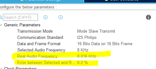

STM32G070: UART speed of 115200 is not possible with PC when running SYSCLK clock at 64MHZ - however is when run at 59.0MHZ
  • July 28, 2020
  • 3940 views
8MHZ HSE crystal. HSE selected and PLLCLK selected.
64MHZ / 115200 / 16 = 34.7222
Assuming the CPU picked 34 as the divisor then the baud rate is 117647.1 2% too high
But setting to 59MHz I was able to successfully communicated at 921,600
59MHZ / 921600 / 16 = 4.0012 (assuming divisor = 4 then 99.9702% accurate)
59MHZ / 115200 / 16 = 32.009 (assuming divisor = 32 then 99.9702% accurate)
What I'm asking for is in the IDE to show the UART Baud rate error, like the I2S device does as below.

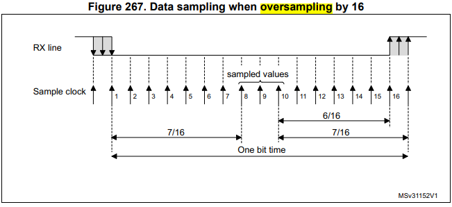

from RM0454 Rev 3 Page771
The oversampling method can be selected by programming the OVER8 bit in the USART_CR1 register either to 16 or 8 times the baud rate clock (see Figure 267 and Figure 268).
Depending on your application:
• select oversampling by 8 (OVER8 = 1) to achieve higher speed (up to usart_ker_ck_pres/8). In this case the maximum receiver tolerance to clock deviation is reduced (refer to Section 26.5.8: Tolerance of the USART receiver to clock deviation on page 775)
• select oversampling by 16 (OVER8 = 0) to increase the tolerance of the receiver to clock deviations. In this case, the maximum speed is limited to maximum usart_ker_ck_pres/16 (where usart_ker_ck_pres is the USART input clock divided by a prescaler).
0693W000003BaJ3QAK.png --end of quoting--
Thus @64MHz using 16x oversampling the maximum baud rate is 4MHz.
So 'ideally' if 16x oversampling, SYSCLK should be a 16x multiple of the baud rate.
or 'ideally' if 8x oversampling, SYSCLK should be a 8x multiple of the baud rate.

Humor me and provide the actual value in USART->BRR with a 64 MHz peripheral bus clock, and 115200 baud rate.
You're not using a 4Mbaud setting, and yes as the rate goes up the granularity of the setting gets rougher.
You're postulating a 115200 baud rate with a 2% error, I think the mechanics, as documented, yield 0.1%, you're interpretation of OVER16 aside.
July 29, 2020
Even though the oversampling is 16x (or 8x), your divisor (USARTDIV/BRR) doesn't need to be a multiple of this. There should by no problem running UART at (about) 115200 with a 64MHz system clock.
Agree with the suggestion to show nominal error.

Hope ST see suggestion for nomimal error.
