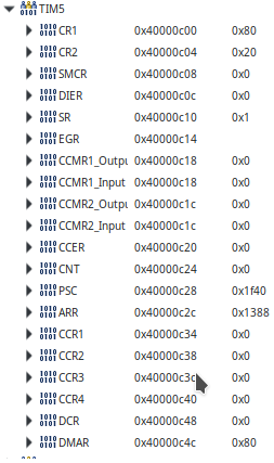

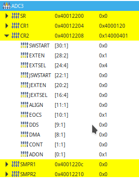

STM32F746G-Discovery ADC3 refuses to trigger off TMR5 (any timer) using default cubemx prj config in STM32CubeIDE Version: 1.3.1. The interrupt from T5 works. ADC works when soft-start. Is this an ADC3 issue? Can I use SWD/trace to see ADC status? How?

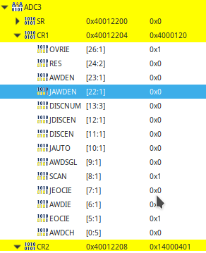

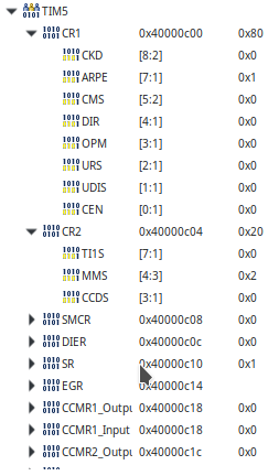

waclawek.jan
Read out and check/post TIM and ADC registers content.

waclawek.jan
TIM5_CR1.CEN=0 i.e. timer does not run.
(It's given away also by the fact that TIM5_CNT does not change).
TIM2_CR2.MMS=0b010 = TRGO from Update appears to be OK as well as ADC3_CR2.EXTSEL=0b0100 = Timer 5 TRGO, and CR2.EXTEN is set, so that looks good too.
You haven't shown the ADC3_SQRx registers, those are important too, determining the channels to be converted and their number. But some conversion should happen even if those are at reset settings, you should see that in status bits (SR.EOC).
