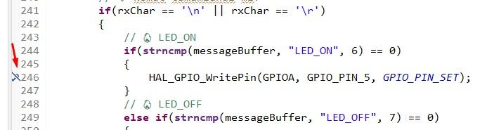

When i try to add breakpoint, there is a cross sign on breakpoint symbol. So even if the code works, breakpoint never works.
I try to add __asm("BKPT 0"); but it also did not work.
I am not sure what is the problem.

Are you trying to place a breakpoint where there is no actual code?
Please show a screenshot of what you're seeing.
Please give details of your board, and what debug probe you're using - see: How to write your question to maximize your chances to find a solution

My board is STM32F407 discovery. I connect my board with USB-cable. For UART, i use TTL converter. I did not do single-step. When UART gets data (LED_ON) command from hercules, with my setup program must stop. But LED becomes on but program did not stop at the line which is on screenshot. I did not use specific probe or any kind of tool. My setup is basic.

Whenever i add breakpoint it displays a cross symbol on it. Videos on internet, other ppl breakpoints doesnt not have a cross symbol on it. I try step-by-step, putting different lines of codes, inside the uart interrupt, outside the interrupt, inside the main etc. Breakpoint is not active. I made search about it but can not solve it yet.

Thank you. I try to figure out for 1 day. On ..flow forum, they mention  a settting which is Run> Skip all Breakpoint. In my setting this is selected. But i am sure i did not select it.
