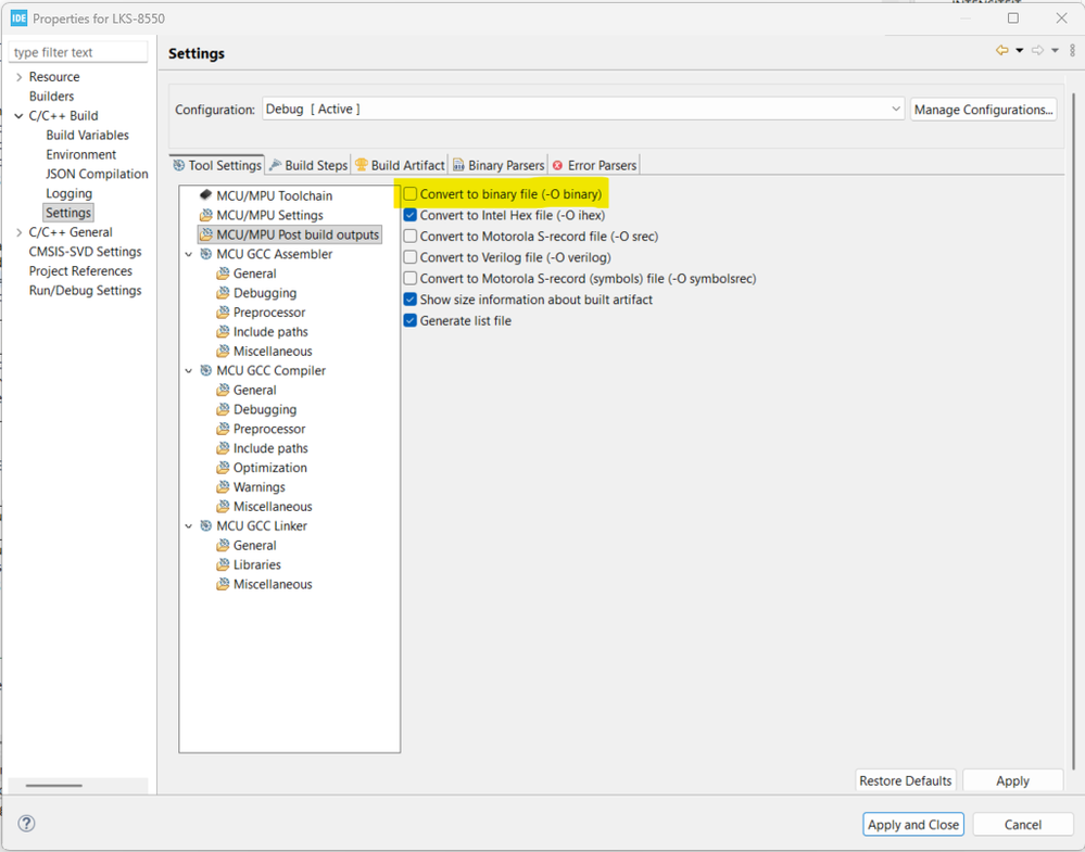

hello ST Community,
Is it possible to generate a binary file that is a *.elf file from a project developed by STM32CubeIDE?
Using the correct settings for generating *.bin files.
The *.bin file would be used to create a bootloader via UART for one of the STM32 microcontrollers.
Thanks for your valuable support.

Hello
Let me thank you for posting.
Right-click on your project, Go to Properties, C/C++ Build → Settings, Tool Settings → MCU Post build outputs.
And enable Convert to binary file (-O Binary), then build the project.

RobK1
Senior II
Project -> Properties

Andrew Neil
Follow-on thread: how to send the binary file to the microcontroller.
Andrew Neil
@Domy_ST wrote:
How to generate a *.bin file instead of a *.elf file
To be pedantic, the solution is not instead of  the .elf - the .bin file is created in addition to the .elf.
