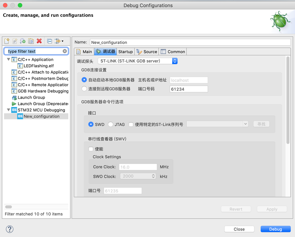

STM32F103ZET error: No device found on target.
RRuan
After I click DEBUG ,it shows that
Error in initializing ST-LINK device.
Reason: No device found on target.
I think it's not hardware's problem because I can download my program in Keil uvision successfully. and my debug configuration is showed as follows:

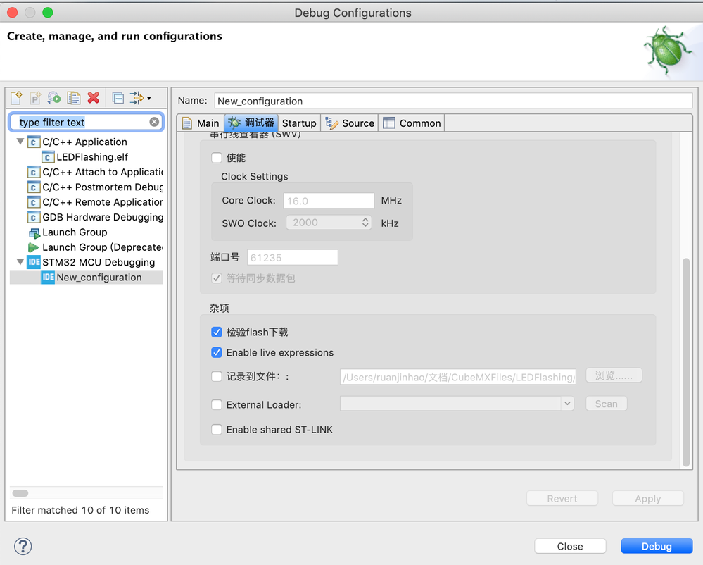

Markus GIRDLAND
Under the "Enable live expressions" there's a box where you can enable a log. Can you activate that one, make a new try to debug and then send me the log?

I activated it, and this is the contents of the file “st-link_gdbserver_log.txt�?

Thank you, but it still doesn't work.
How is your workspace and installation set up?
I noticed the log gets logged to "文档/CubeMXFiles/TEST/Debug/st-link_gdbserver_log.txt" and any non-ascii characters in workspace path, installation path, project name or workspace name can give bad results.

I changed my workspace path into English and reinstalled CubeIDE, but this error still exists. and this is the new "st-link_gdbserver_log.txt"

So neither workspace path nor installation path have any non-ascii characters now?
Is it some kind of custom board? I would make sure contact with the board is good and also make sure you point out the correct ST-Link in the debug configuration if you have multiple connected or perhaps a previous one saved.
Do you have TrueSTUDIO or stand alone CubeProgrammer installed? If so, what are the results with those tools?
This error is usually due to a simple connectivity issue.
