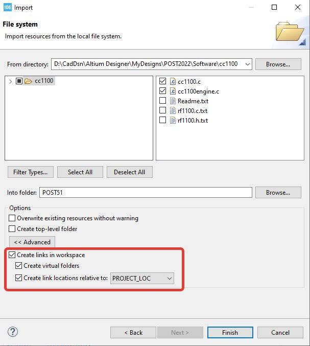

I make a project with two LINKED .c source files. When debug session is started I cannot set any breakpoints inside those files. If I keep it as non linked - all OK while debugging. But this files must be linked, because it shared between two projects. How to fix this issue?

I add those files as in the pic:As a result this files now part of my project:
Compiling is OK. But when I start debug session any breakpoints settling inside are non functional for me. Can you try this for any of your projects? I use ST-LINK v2 (GDB server) connection.

Found a fix for all of us! We need to edit 'Debug Configuration' Source tab. At this tab simplify add 'New compilation directory' container and a path where your linked С source files placed. Next, restart debug session and linked files now debuggable and breakpoints can be inserted.
However, it's wondering for me: project compiled OK, so Eclipse engine have enough information where project sorces files placed. And Debug configuration lookup path can be updated automatically...
