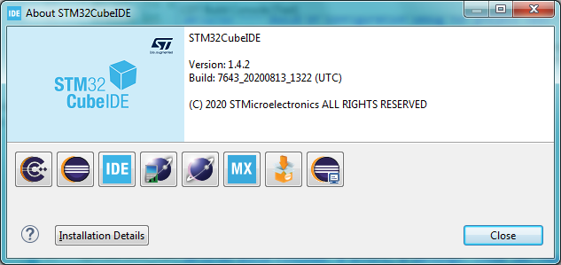

Using STM32CubeIDE version 1.4.2 on a Windows 7 64-Bit Home Premium Edition, Version 6.1 (Build 7600) laptop, I am unable to program and debug a project on a NUCLEO-F401RE board.

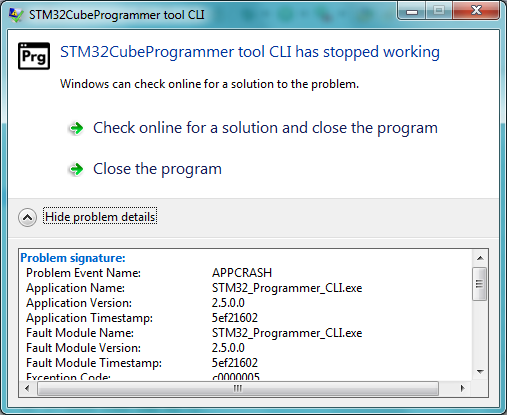

When I attempt to debug to program the board and debug and run the firmware, I get an error dialog "STM32CubeProgrammer tool CLI has stopped working" and am unable to continue.
The full details from that dialog window are shown below:
Problem signature:
  Problem Event Name:	APPCRASH
  Application Name:	STM32_Programmer_CLI.exe
  Application Version:	2.5.0.0
  Application Timestamp:	5ef21602
  Fault Module Name:	STM32_Programmer_CLI.exe
  Fault Module Version:	2.5.0.0
  Fault Module Timestamp:	5ef21602
  Exception Code:	c0000005
  Exception Offset:	000cd5ce
  OS Version:	6.1.7600.2.0.0.768.3
  Locale ID:	1033
  Additional Information 1:	0a9e
  Additional Information 2:	0a9e372d3b4ad19135b953a78882e789
  Additional Information 3:	0a9e
  Additional Information 4:	0a9e372d3b4ad19135b953a78882e789

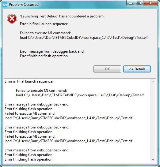

When closing that error dialog I get the following error dialog from STM32CubeIDE:
Then in the STM32CubeIDE console was reported:
Encountered Error when opening
C:\ST\STM32CubeIDE_1.4.0\STM32CubeIDE\plugins\com.st.stm32cube.ide.mcu.externaltools.cubeprogrammer.win32_1.4.0.202007081208\tools\bin\STM32_Programmer_CLI.exe
