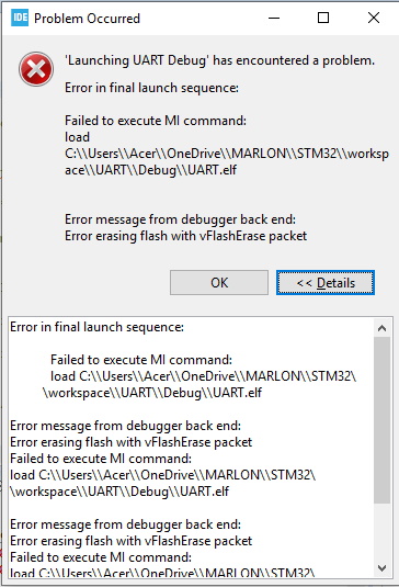

Hi!
I see when you choose Debug probe: ST-LINK (OPENOCD), it works for you. My question is: Which programmer/debugger do you use? I'm ussing ST-LINK v2 (chinese clone) and when I choose the same debug probe and clic "Debug", It show me an error.
So I will you very grateful if you let me know which programmer/debugger do you use? and if you use ST-LINK v2 chinese clone, too, How can I set it to use it with ST-LINK (OPENOCD) debug probe.
Thank you so much.

Hi, everyone!
It works for me: http://shawnhymel.com/1840/how-to-use-semihosting-with-stm32/
I hope it help you.
Bye.
