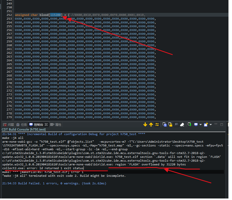

I want used QSPI flash running program. W25Q64, used stldr file is ok,but always have problem,Build error,region FLASH overflowed by 31220bytes,I have a big photo array,more than internal flash 128k,I search before post,change this flash.ld file?I have no idea.Could you please help me?

You'd need to modify the .LD to add a QSPI section, if not already present.
You'd then __attribute__ the static/const allocation in the compiler to direct it into the QSPI section.
Something along the lines of:
/* Specify the memory areas */
MEMORY
FLASH_QSPI (rx)    : ORIGIN = 0x90000000, LENGTH = 8192K
 /* Constant data goes into QSPI FLASH */
 .roqspidata :
  . = ALIGN(4);
  *(.roqspidata)     /* .roqspidata sections (constants, strings, etc.) */
  *(.roqspidata*)    /* .roqspidata* sections (constants, strings, etc.) */
  . = ALIGN(4);
 } >FLASH_QSPI
__attribute__((section(".roqspidata")))
static const unsigned char buffer[] = {

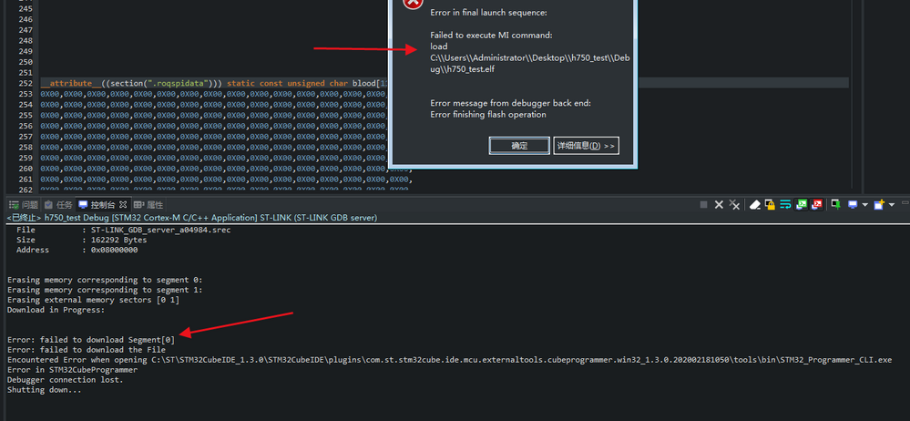

Thanks you very much!!!the problem is solved.but appear new problem.
0693W000006F4s6QAC.bmpisn't my stdlr wrong?

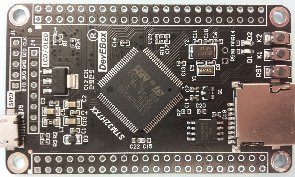

This is the External Loader for the W25Q64B on the MCUDEV DevEBox H750 board (should also work with the H743 model)
0693W000005CDSMQA4.jpg#MCUDEV #DEVEBOX #STLDR
