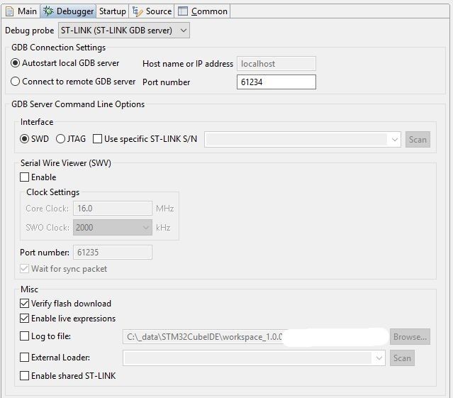

I also tried with the same three initialization commands (yes, I had initially picked the wrong addresses which came from some old debug config setup that I had)
set *0xe000ed08 = 0x08020000
set $sp = *(unsigned int*)0x08020000
set $pc = *(unsigned int*)0x08020004
Yes, I selected ST-Link as debug probe:

Have now also tried with an STM32F4DISCOVERY board and example project using CubeIDE and debugging works without any problems using ST-Link (onboard of the eval board).
But I can't figure out what the difference is here (except from the fact that my own program is located at another flash position and thus needs the additional initialization commands)...
Using the following initialziation commands, the execution of the command is always trapped in the Default_Reset_Handler:
set host-charset CP1252
set target-charset CP1252
set *0xE000ED08 = 0x08020000
tbreak main
continue
So I thought that maybe there's some problem with my linker file, but in Atollic TrueStudio it worked without problems - likewise with the J-Link in CubeIDE...
Any ideas?

I just tried that. I copied my sources and linker script to the working project and set the corresponding includes. However, the effect is the same - Debugging with J-Link works, but using the ST-Link execution hangs in the Default_Reset_Handler...
