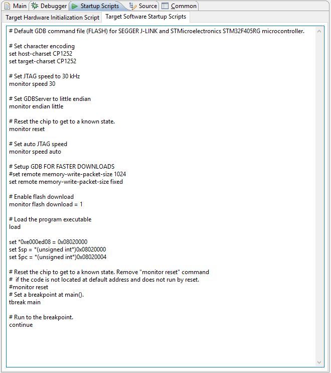

I used the following "Target Software Startup Script" in the debug configuration in Atollic TrueStudio (this is necessary since we're using a bootloader and our application binary which I would like to debug is not placed at the beginning of the STM32 flash):
How to enter this in STM32CubeIDE?

Yes, I originally had used the wrong flash addresses in the gdb commands (taken from an old linker script). Now I use the following initialization commands for J-Link:
set *0xe000ed08 = 0x08020000
set $sp = *(unsigned int*)0x08020000
set $pc = *(unsigned int*)0x08020004
Since it works this way with the J-Link, I assume that both the addresses and the linker script are ok and the only problem lies in the gdb commands.

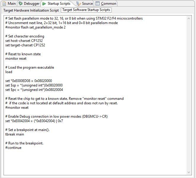

I noticed ST-Link and J-Link use two different (custom) versions of the gdb server. So I guess maybe the ST gdb server needs some addtional command. Even in Atollic TrueStudio I had different startup scripts for ST-Link and J-Link.
For ST-Link I used:
For J-Link I used:
I tried to use the same in CubeIDE. The first problem was that I didn't know where to enter it. So now I know that part of it needs to go to the initialization commands, part of if can be set via the "runtime options". However, some commands don't work with CubeIDE any more (and comments don't work at all - as you well know as I've read on your other post). Removing them enables to start the debugging, but traps the application in the "Default_Reset_Handler" function.
