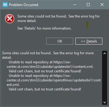

after installing STM32CubeIDE v1.11, I get the following error when running Help-->Check for updates
I've already tried the hints from other posts like clearing the cache, checking proxy, checking the https addresses, etc.
Other updates work, like Help-->Check for Target Selector Device Database Updates.
I've also uninstalled STM32CubeIDE completely and freshly installed v1.13 but the behavior remains.
Any help would be appreciated.

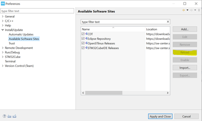

Also, reload OpenSTLinux Releases under preferences-->available software sites, as shown in this screenshot

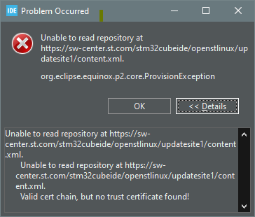

Hello Rim,
Native provider was activates but I cannot find "Window --> Preferences--> Firmware Updater, Check Connection"
Reloading OpenSTLinux Releases results in the same error message:
Thank you.
