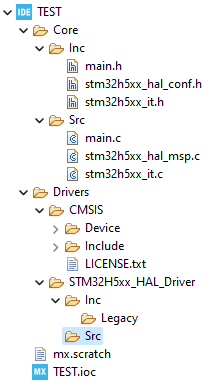

I have an issue when creating a new project through STM32CubeIDE.
I use the application on Windows, it is STM32CubeIDE v1.16.0 and I try to work on an STM32H563ZI.
I installed it off line (security constraints preventing any network connection) so I installed the Application as well as the STM32CubeH5 package by manually downloading and installing them.
The issue I'm facing is that when I follow the usual procedures to generate a new project, said project doesn't seem to be an Application and therefore cannot be built, debugged nor launched.
The following image is the project generated :
As you can see, many elements seem to be absent. I am a beginner in STM and STMCubeIDE, so maybe I didn't get all the necessary packages or something, but I'm really stuck on this and I can't find a solution for this.
If anyone knows how to solve this issue, please let me know!
Many thanks,
Quentin

Jul 19, 2024 8:22 AM UTC
Hello!
Thank you very much for your answer.
Yes, by usual I mean the process explained in the various docs :
  > menu > File > new > STM32Project > /select your target cpu or board / > /+give new name/ > finish.
  >Then select in Cube , what you want (Minimum: debug serial wire , + clock tree without errors)
  >Then gen.code , compile, start (setup..) debug and try.
I tested the IDE on another computer (MacOS) with network compatibility and everything went fine, I could build/upload my code to the board without issues. What I meant is that I followed the same steps but without success this time. I'm stuck at this part :
I cannot build the code (the option isn't even there). And trying to launch the debug/run options result in the "The selection cannot be launched, and there are no recent launches" error. My main theory is that I'm missing some packages to get the App to work as intended but I cannot find which ones...
