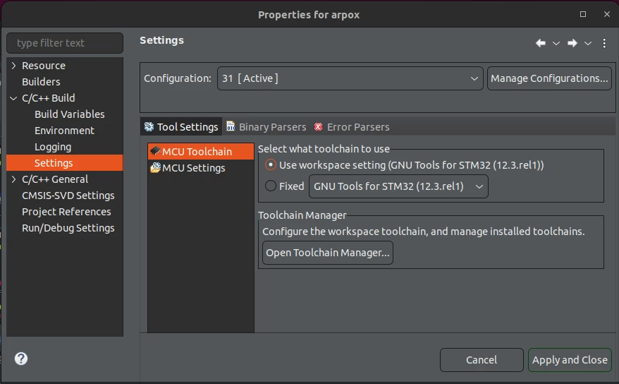

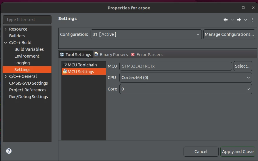

I get this compilation warning: The float formatting support is not enabled, check your MCU Settings from "Project Properties > C/C++ Build > Settings > Tool Settings", or add manually "-u _printf_float" in linker flags.
The stated "recipe" to fix the issue does not work because there is no "linker flags" edit box in the mentionned dialog.
Hence, what is the way to add linker flags in the IDE version I'm using, 1.15.1 ?
Many thanks!

You are right, when I select the standard build, more options appear.
Interestingly, the values I specify for the flags are used by the IDE when analyzing my code, even tough I revert to my custom build method.I thus no longer get the warning.
So the recipe was: use standard build, change the parameters that are now available, revert to my own custom build method.
