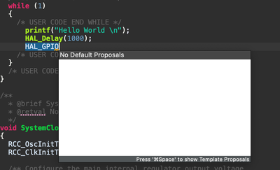

Quickly, I hit an issue: auto-complete proposals (Ctrl+Space) gave no proposals in STM32CubeIDE. The pop-up window only shows 'No Default Proposals'

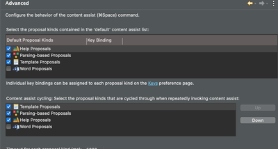

UPDATE: I fixed it, the preferences setting needed to be a little bit different than in TS.
In Preferences -> C/C++ -> Editor -> Content Assist -> Advanced
I checked the following boxes:
  • Parsing-based Proposals
Both in the upper and lower window.

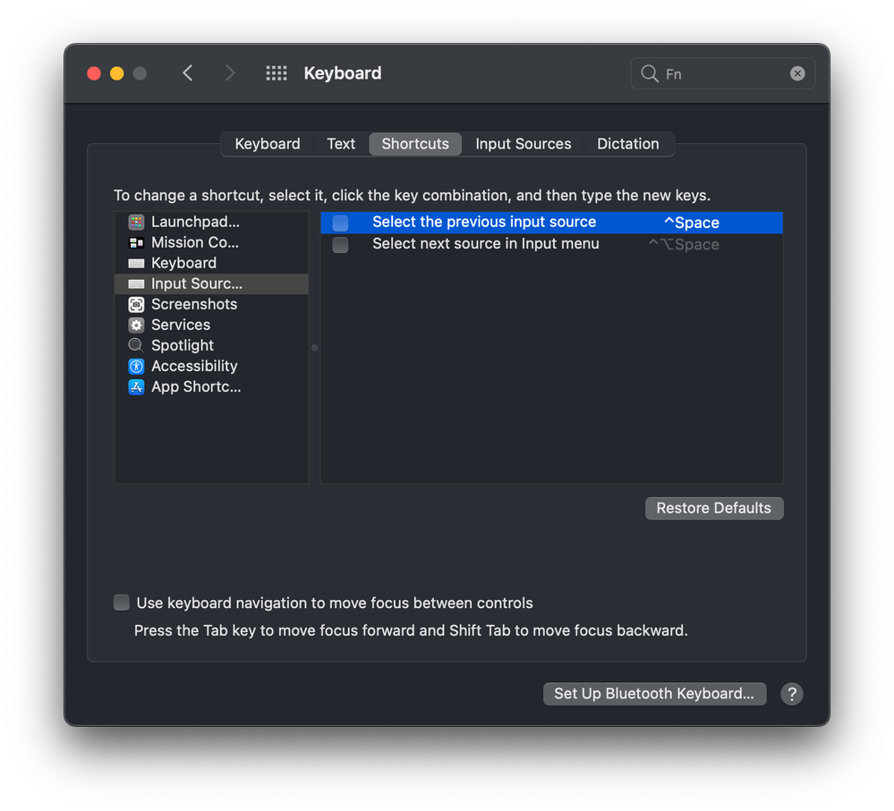

I had this too when I installed the latest CubeIDE on my Macbook Pro on mac OS Big Sur 11.7.2.
I changed the dark mode back to classic and then found out I the autocomplete (Ctrl-Space) didn't work.
After long searching and trying I found out that Fn+Ctrl+Space however DID work!
So, I checked the settings in OSX and found a conflicting shortcut:
(System Preferences > Keyboard > Shortcuts > Input Sources > Select the previous input source)
After disabling this unused setting, CubeIDE's autocomplete worked again with Ctrl-Space.

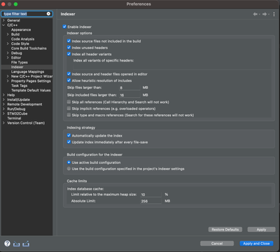

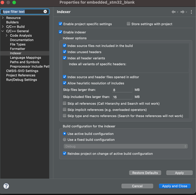

I found the issue from this: https://community.st.com/t5/stm32cubeide-mcus/why-does-the-index-not-work-and-how-to-make-it-work/td-p/269134

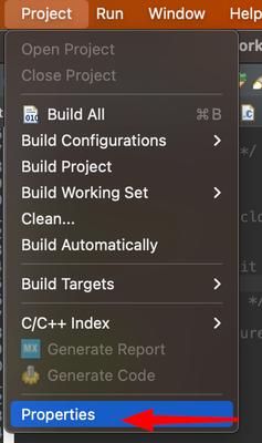

The indexer needs to be enabled within the project. Go to Project -> Properties
Then C/C++ General -> Indexer
I checked all the boxes and it worked. It may also be helpful to enable the indexer in CubeIDE preferences.

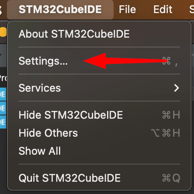

STM32CubeIDE -> Settings
C/C++ -> Indexer, and I checked all the boxes.

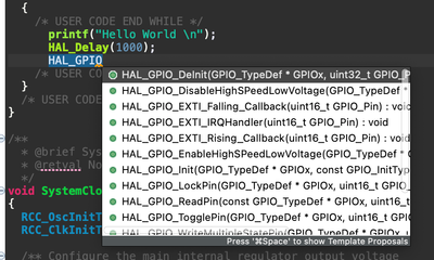

I can see suggestions for autocompletion:
