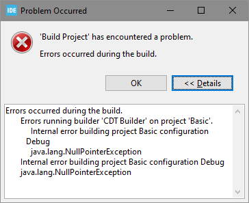

In the "bad" workspace choosing the "internal" builder and trying to build a project, a severe error occures:
Errors occurred during the build.
Errors running builder 'CDT Builder' on project 'Basic'.
Internal error building project Basic configuration Debug
java.lang.NullPointerException
So, I think, the problem is not in the console but in the fact, that the internal builder is invoked to build a single file, it crashes, and the console has nothing to show!
Now the question is, how to repare this issue with the internal builder?

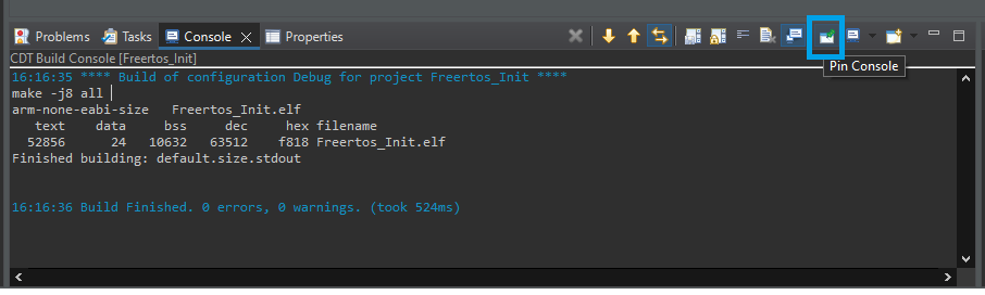

About the second question I think that you accidently clicked on "Pin Console".
Check if the button shown in the screenshot is not pressed on any console in your workspace.

In the "good" workspace it does not matter, pinned or not: I see the output of the builder anyway. The main issue is no more the console but the fact, under the "bad" workspace the internal builder crashes:
Later, since for building of a single file always the internal builder seems to be engaged, it crashes silently, and the console shows nothing...

I'm afraid, you did not read my previous report regarding two projects under the workspace with the issue. Regardless of your assert, if you support or not the internal builder, the symptoms are that the IDE does support both builders, and when building/translating a single file the internal builder is engaged regardless of the project setting "use internal" or ".. external" builder. I have no issue to use the external one (and I do it!), but the point is, I cannot build a single file (what I used to as a convenient way to check the syntax quickly) because the IDE seems to engage always the internal one for this purpose that crashes in my project "Basic". At the same time, in the same workspace(!), another similar project generates no errors when building a single file. Conclusions:
- your IDE does support internal CDT
- some broken project setting under "Basic" makes something to crash (see the log).
