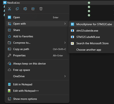

In order to open successfully the Ioc.File on STM32CubeIDE 2.0, you need to open it by default on the project folder with MicroXplorer for STM32Cube application.
Thanks.
Mahmoud
