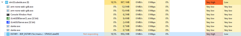

Some weird Build Project thread gets started, which never ends and prevents any other operation. Even trying to edit a source file is stopped, due to this mysterious "build" in progress. You get the message "The user operation is waiting for background work to complete."
After a while the IDE stops responding altogether, the load on the CPU is Very high, and the only possible thing to do is terminating it from the Task Manager.

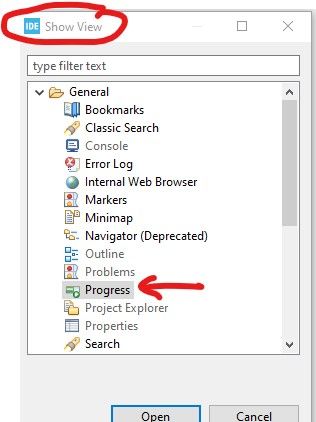

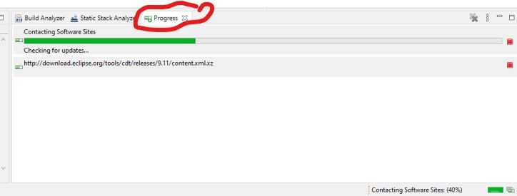

Then CPU running high any info as part of Progress view (Windows > Show View)?
Dear Markus,
On both my systems it happened without any trigger. Its not possible to give you a guide because its enough to make a new projekt, then its happen after few seconds. In the first few seconds after generation of new projekt, it works with normal speed but then changed that.
Also progress window shows nothing.
Nothing happens in Progress. It happen in system with one project and also multiple project in the same workspace.

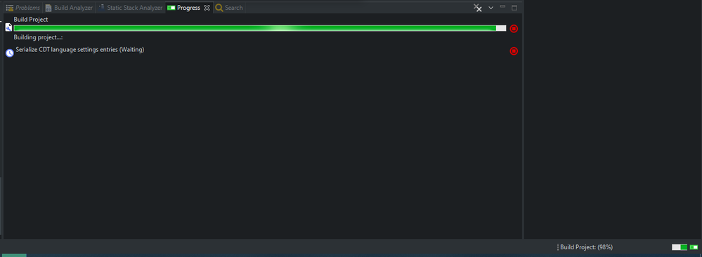

I had the "Debug Configurations" dialog open, but when I tried to press the "Debug" button the IDE got unresponsive.
I noticed the dreaded "Build Project" stuck at 98% (see image attached).
0693W00000APCNMQA5.pngI had to kill the IDE from the task manager, but I had already changed the log "Threshold" to "DEBUG". I attach the log files too.
Thank you for any help.
