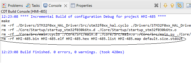

i read Previous posts and set project properties for generate hex file but i see they remove after they build. why?

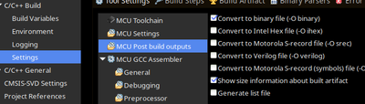

so you set hex-output here :
yes
i open new project and change directory from "D:" to "C:" and it solved
