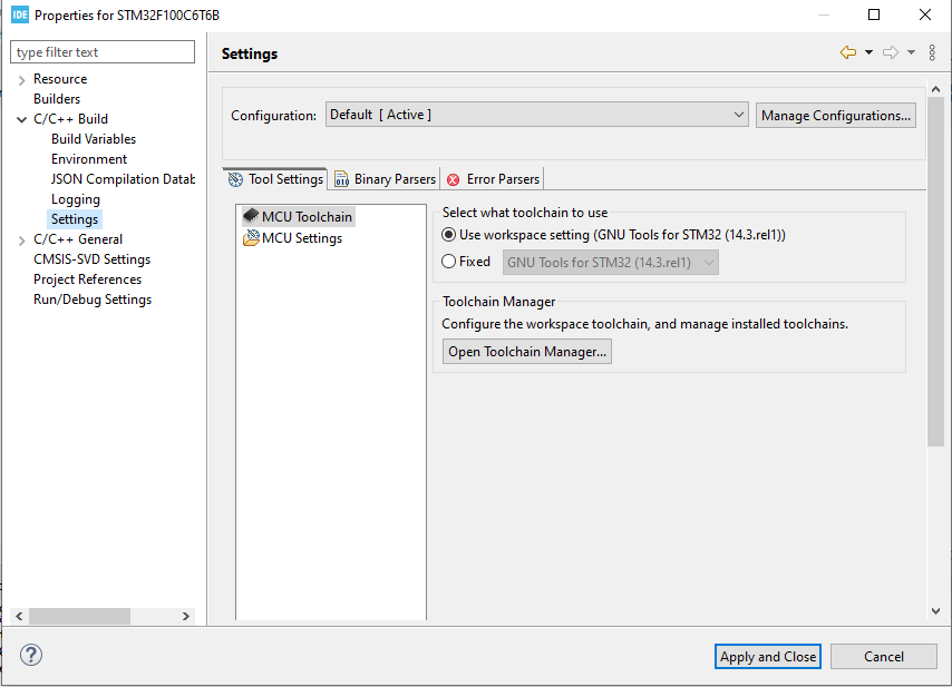

Build Failed. 1 errors: Cannot run program "make": Launching failed
XooM
Senior
18:15:49 **** Incremental Build of configuration Default for project STM32F100C6T6B ****
make all
Error: Program "make" not found in PATH
PATH=[C:/ST/STM32CubeIDE_2.1.0/STM32CubeIDE//plugins/com.st.stm32cube.ide.jre.win64_3.4.200.202601091518/jre/bin/server;C:/ST/STM32CubeIDE_2.1.0/STM32CubeIDE//plugins/com.st.stm32cube.ide.jre.win64_3.4.200.202601091518/jre/bin;C:\Program Files (x86)\NVIDIA Corporation\PhysX\Common;C:\Windows\system32;C:\Windows;C:\Windows\System32\Wbem;C:\Windows\System32\WindowsPowerShell\v1.0\;C:\Windows\System32\OpenSSH\;C:\Program Files (x86)\Windows Kits\8.1\Windows Performance Toolkit\;C:\Program Files (x86)\STMicroelectronics\STM32 ST-LINK Utility\ST-LINK Utility;C:\Users\tunca\AppData\Local\Microsoft\WindowsApps;C:\ST\STM32CubeIDE_2.1.0\STM32CubeIDE]
18:15:49 Build Failed. 1 errors, 0 warnings. (took 142ms)
I prepared my project in version 1.19. At work, I opened it in version 2.0 and compiled it once.
Now I can't open it on my home computer.
I installed version 2.1.0 on my home computer, but I'm still getting errors. How can I continue with my project?

Andrew Neil
This is the 1 error:
make is the tool used to do the build - it's what decides which files need to be rebuilt.
The message is telling you that make is not (properly) installed.
So something is wrong with your installation - try uninstalling and reinstalling.

@XooM wrote:
i cant open my project by using CubeIDE..
What you show there is nothing to do with opening the project; that's an error with building the project - you can't get that before the project has been successfully opened.

I have a few questions regarding STM32CubeIDE, and I want to make sure I understand the behavior before posting them on the forums.
I was working on a project with STM32CubeIDE version 1.19, and it was running perfectly. Recently, I opened and compiled the same project in version 2.1.0.
Question 1:
If I compile my code with the new version and upload it to my previously stable board, is there a chance that it might behave differently or become unstable? I haven’t changed any of the code itself — only opened and built it in the latest version of STM32CubeIDE.
Question 2:
I cannot find the optimization settings for the STM32F100C6T6 in STM32CubeIDE 2.1.0. Where can I locate them?
Question 3:
In STM32CubeIDE 1.19, I compiled my project with the -Ofast optimization and generated the .hex file. In version 2.1.0, I cannot figure out how to change the optimization settings. How can I set -Ofast in the new IDE?
Projects don't corrupt themselves spontaneously.
It looks like your project is not properly configured. Probably it was imported wrong. Perhaps start with a new project and copy code over.
Your post is lacking in detail. You created a project on one computer, it works, then you're opening on another. How? Projects must be imported correctly. Opening the .project file works.
This has nothing to do with the STM32CubeIDE version. I suggest debugging as if it were a project issue rather than a STM32CubeIDE version issue.
Of course, since your CubeIDE version on the home computer is 1.19, the path above is invalid.
Compare the .project and .cproject files after building on the other PC vs. state before. Find the diffs and revert bad diffs.
/* If you have not saved the project state before moving to the other PC (made a backup or used github or other version control) - you've just received a valuable lesson */
The project options on your screenshot of CubeIDE 2.1.0 do not look good. The tools settings for the compiler and linker are missing. Something got broken. Try to refresh the project.
