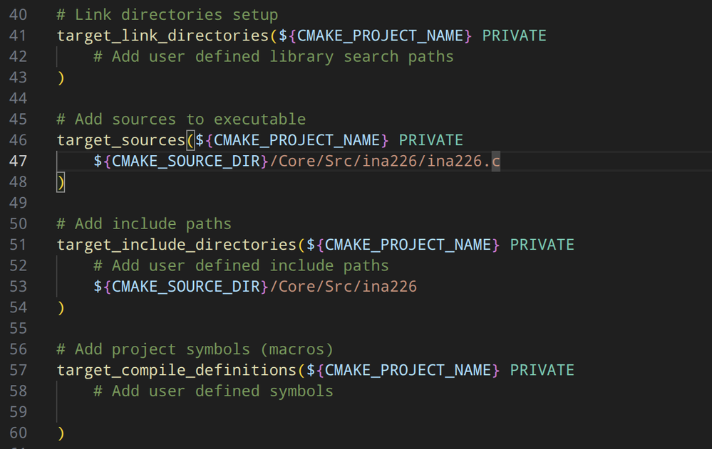

I wrote my own source file. It is located in the Core/Src directory. I have also entered it accordingly in cmakelists.txt.
my cmakelists.txtmy cmakelists.txt

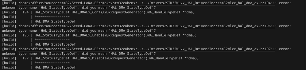

Now I get an error saying that the include files from the Drivers directory are missing.

If I remove my entry, I no longer get the error. But then I can't use my customs. Is there a sample cmakelists.txt that includes customs?

If it's like other families, you should only include the top-level "stm32wlxx_hal.h", and not individual HAL files.

for me seems an include issue, how did you manage the includes in your custom file please ?
Hi @Nawres GHARBI ,
i include the
    stm32wlxx_hal_def.h
think you i must include the another files?
Thank you, was a little mistake, but a big search.
t_j_l
You should modify it to Core/Src/ina226/ina226.c
