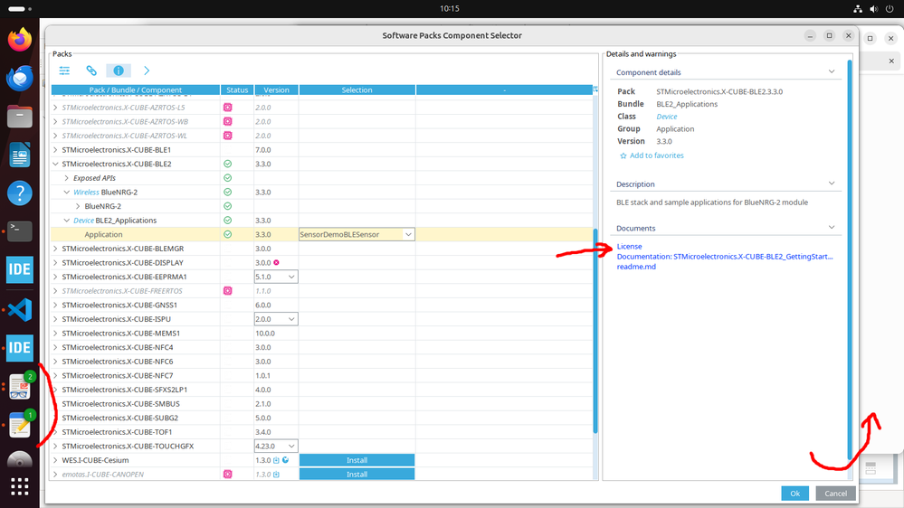

When I view the information panel after selecting the "X-CUBE-BLE2" -> "Device BLE2_Applications" -> "Application" -> "SensorDemoBLE..." and clicking on the "Documentation: STMicroelectronics X-CUBE-BLE2_GettingStarted..." link, the "Software Packs Component Selector" popup window hangs and cannot be closed.  The document is never displayed.
From what I can tell, it is attempting to load "/home/me/STM32Cube/Repository/Packs/STMicroelectronics/X-CUBE-BLE2/3.3.0/Documentation/STMicroelectronics.X-CUBE-BLE2_GettingStarted.pdf".
I ran the IDE software updates via the "Help" menu yesterday, so I assume it is the latest version.  The command line shows it is running "/opt/st/stm32cubeide_1.12.0//plugins/com.st.stm32cube.ide.jre.linux64_3.1.0.202310310920/jre/bin/java" with "-Dosgi.instance.area.default=@user.home/STM32CubeIDE/workspace_1.14.1 -Declipse.buildId=Version 1.14.1"

There were other non-java processes running which seemed related using the path "/home/me/.stm32cubeide/.jxbrowser-7.35.1/Chromium/chromium".  I terminated them, but the popup window is still not responding.
It appears the java AWT Event thread is hung.  The stack trace is:

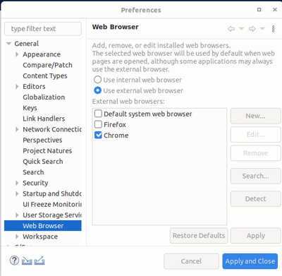

I think I've fixed the issue with the "Information Center" links not working.
I went to "Window" -> "Preferences" -> "General" -> "Web Browser" and changed it to "Use Internal web browser" and selected "Chrome", then clicked "Apply and Close".
Testing further it seems that "Firefox" and "Default system web browser" does not work, but "Chrome" does whether or not "Use internal web browser" or "Use external web browser" is selected.

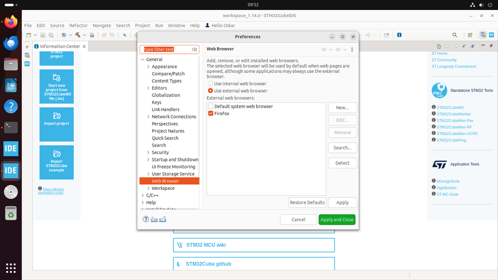

almost same issues here on Ubuntu 23.10, a lot of links in STM32CubeIDE 1.14.0 are just doing nothing when clicked:
menu Help > Video Tutorials
Information Center > STM32CubeIDE resource portal on wiki
Information Center > STM32 videos > any video...
Information Center > STM32 MPU wiki
Information Center > STM32 MCU wiki
Information Center > STM32Cube github
Information Center > Support & Community > any link...
Information Center > Standalone STM32 Tools > any link...
Information Center > ST Application Tools > any link...
Information Center > Data collection information notice
==> ALL of these are just "click and wait forever while nothing happens" things !
About the X-CUBE-BLE2 documentation issue, I have a different behavior: when I click on any link from "Documents" section, it gets opened by either a text editor or a pdf viewer (as you can see in the apps menu bar on the left) but their respective contents are always hidden behind the "Software Packs Component Selector" window ! Then I just cannot read anything until I close this window or reduce its size... but no hang so far.

@Oskar_H
This also fixes the hanging issue I originally posted.
Oskar_H
Senior
Helo @snacker ,
thanks for your advice but I have tried all combinations of Web Browser settings in Preferences > General and none of them work.
Note that I don't have Chrome installed on my system, only Firefox... But I expect it to be launched when choosing "Use external web browser" and either "Default system web browser" or "Firefox" !

snacker
@Oskar_H , I did some more research on this.  It appears that it (eclipse in general) only works with older versions of Firefox.  You might want to try to install Chrome and see if that works (with Chrome selected in the settings).
