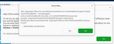

‎2024-08-19 3:44 AM
These do however leave something behind:
