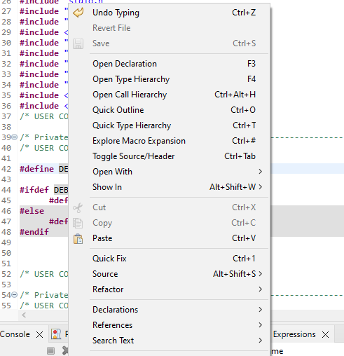

It wont let me go to definition. Clicking go to declaration doesnt go anywhere.0693W00000Nqe4sQAB.png

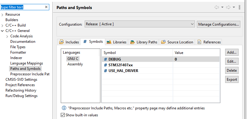

It should be simple - DEBUG should just be defined for the 'Debug' configuration in the Project settings.
But that fact that it's not working shows that something's gone wrong ...
If those prints are still appearing, DEBUG must be getting defined somewhere.
Or you're not loading the code you think you are.
0693W00000Nqe4iQAB.pnghave you checked that?

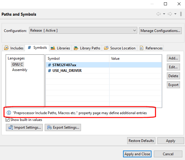

I cant find this property page

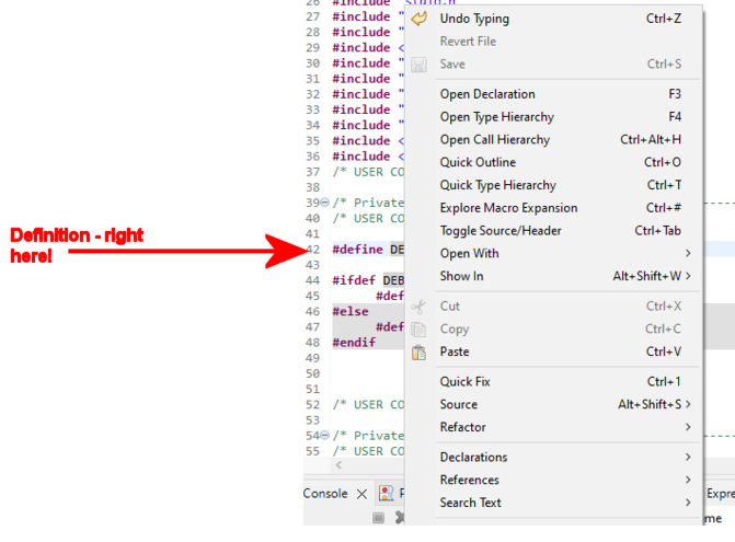

"I have manually set the DEBUG variable to 0 and so the debug printf should not work if I understand this correctly"
You misunderstand.
I explained this earlier:
#define DEBUG 0
that is a definition of DEBUG; you have defined it to be zero - so it is defined!
Therefore
#ifdef DEBUG
will be true - so all the prints will be enabled.
"'ifdef" means "if defined"
If you want to test the value that has been defined, you need:
#if DEBUG == 1
	  #define DEBUG_PRINT(X) printf X
#else
#endif

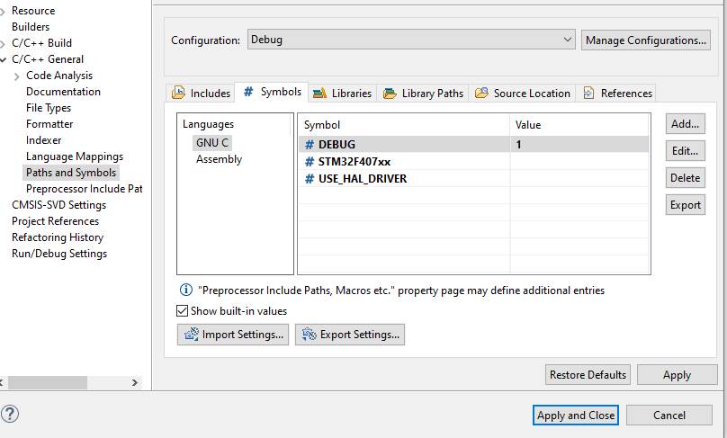

Ok I understand now. I did the following:
For release I define debug 0
For debug I define debug 1
Then in my main.c:
#if(DEBUG==1)
#else
#endif
Now the DEBUG_PRINT only works when I am in debug mode exactly how I want to!
